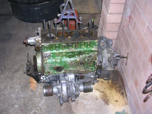

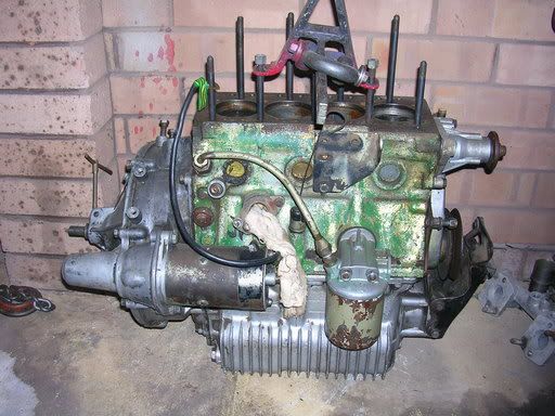

Well I have now located a good baisis to form my new engine and gearbox mega power package.
This motor will be very refined with some new age technoligy and some special GR items.
I will be taking some time for the build up as my current motor is going well and money will be saved so I can purchase most of the items at the same time.
here is the complete std setup waiting for striping.

hey Gaf, no side covers, so 1275 LS or 1100 S
PostPosted: Fri Jul 15, 2005 10:58 am
Posts: 39752
Good block for a turbo, they bore better than A+ Metros do. Less crap in the castings... 8)
