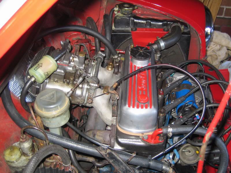

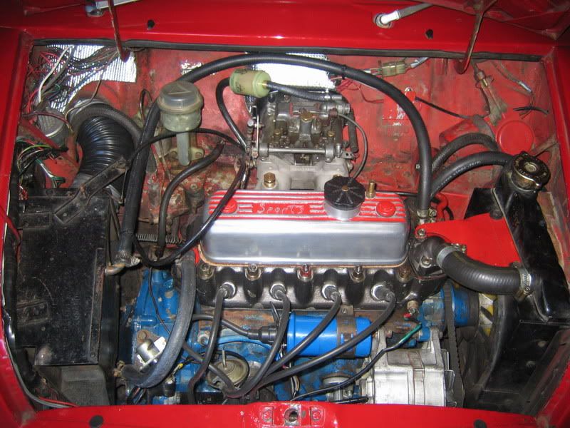

PostPosted: Mon Jul 04, 2005 10:07 am
Posts: 6858
Here she is:
Not quite as pretty as some but it's function over form at the Strathfield Works Mini Garage 8)
Lillee - 1969 Morris Mini K
