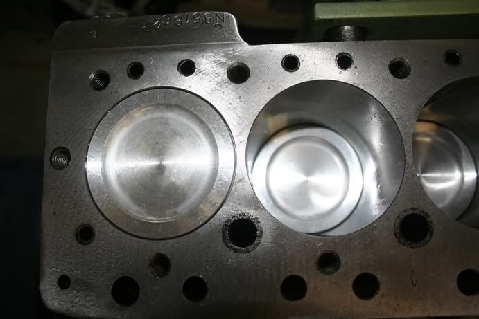

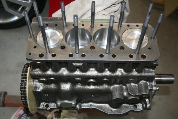

A bit more progress.
I fitted the pistons into the block, fitted the crankshaft, camshaft, oil pump and new twin row timing gear. Now need to track down a dial gauge so I can check the camshaft timing is correct.

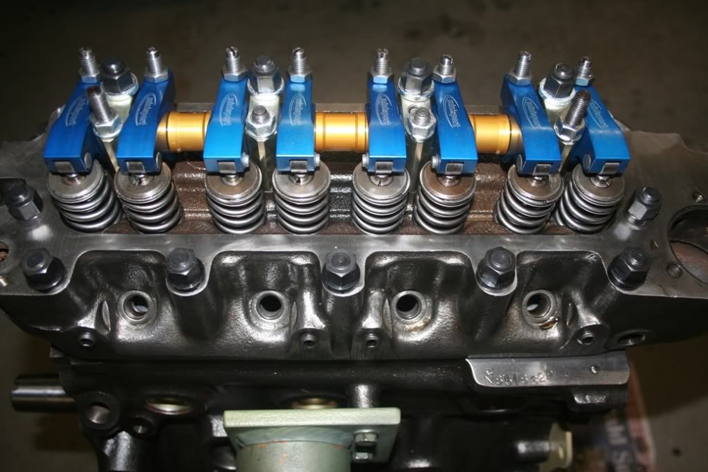

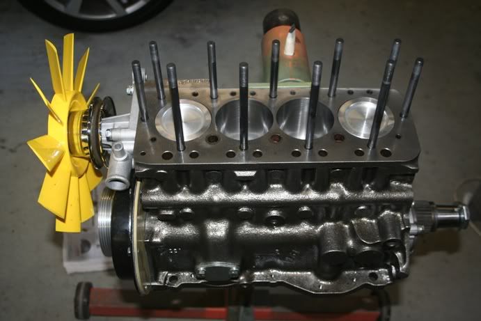

Some photos from last few days work on the engine

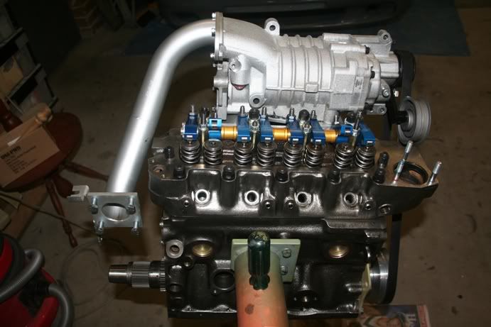

Minispares head studs fitted
Head and rocker gear fitted
I was dissappointed I had to file down the centre spacer on the Minisport rocker gear by a few thou so as to stop the binding of the 2 inner rockers and pack out the 2 outer rockers with a thin washer so as to reduce the play.

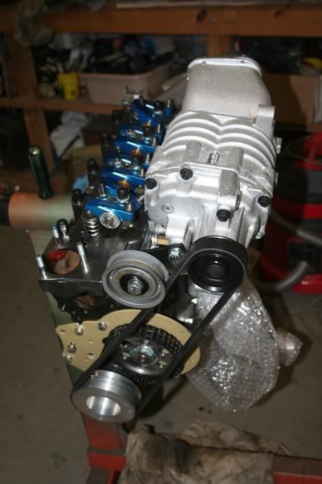

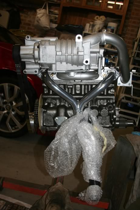

Did a trial fit of the Supercharger tonight.
Lines up on the head studs very nicely and seems to fit well. :) :)
Now for the rest of the engine and gearbox.

Mine is pretty much complete but everyone I have spoken too tells me not to run the pulley without a damper. I argue that they would come with it if required but folks with lots more experience than me say otherwise.
I have had a damper attached to the pulley, though now it fouls the engine mount so need some mods done there. Seriously thinking custom gilmer pulley may be the way forward.

This engine originally had a crappy tin pulley with no damper and I was going to buy a new harmonic balancer but obviously that wouldn't fit now.
So far no one else has advised against just fitting the pulley.

PostPosted: Wed Mar 02, 2011 6:35 pm
Posts: 39752
IMO crank life in a road 1275 or bigger will be seriously reduced without a good damper fitted. Vizard agrees. read da book....
You might get away with it in a hillclimb or drag car where engine life is measured in hours... :lol:

Posts: 3166
At this stage the car will only be used for weekends. My Cooper S which was restored 15 years ago has only 22000 miles since the resto, so I expect this car will be used in a similar fashion.
But I will check with GR when I see him next, although he has seen the kit and made no comment on the pulley at that time.
I must admit I can't see how you could fit a damper to the pulley as there would be no space between it and the radiator?

PostPosted: Wed Mar 02, 2011 9:02 pm
This space for rent
Posts: 5455
Ask BALLISTIC how long his roadie 1275 lasted when his $$ Romac damper shat itself on the way home from the Asparagus Job in '09. I know, I was 8 hours behind him on the road, and bought a good s/h standard one in Narellan and ferried it down to him ;)
No way I'd run anything bigger'n a 998 without a damper. Even a tuned 998, I'd probably fit one for the peace of mind...

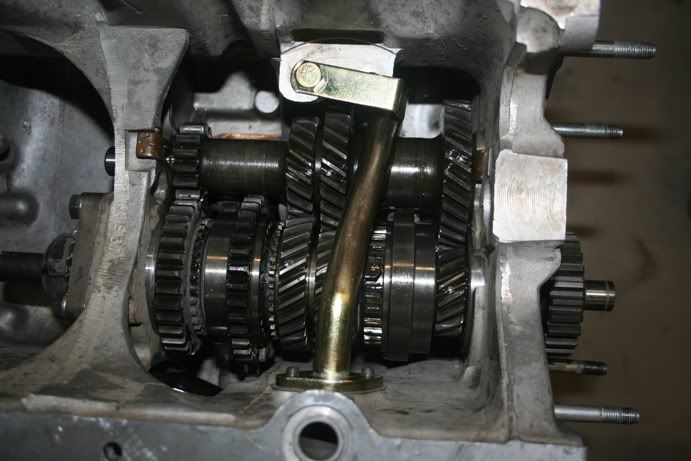

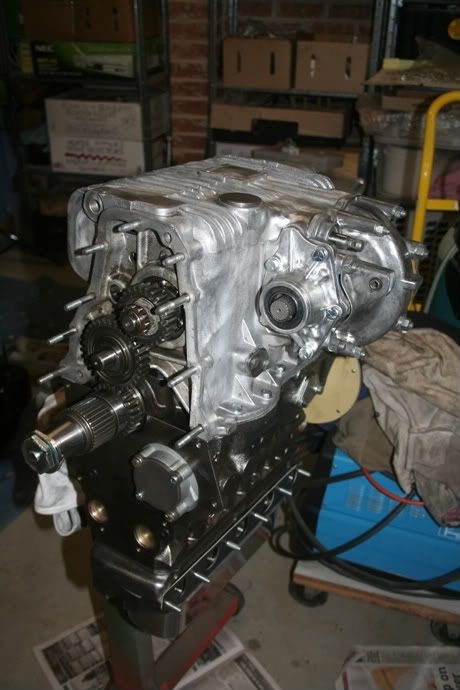

Some more progress, although much slower than anticipated. :(

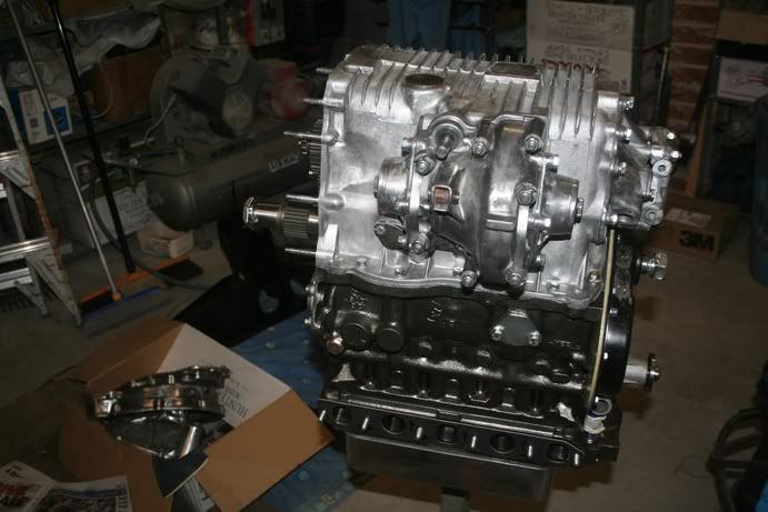

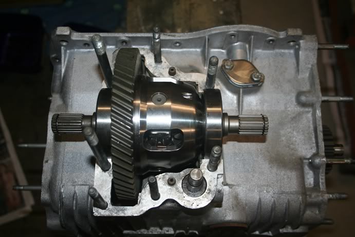

Pulled the gearbox apart and checked it, only found a worn layshaft which is now replaced with a new toughened version.
Reassembled with a new central oil pick up
4 pin diff and 3.2:1 crown wheel and pinion.

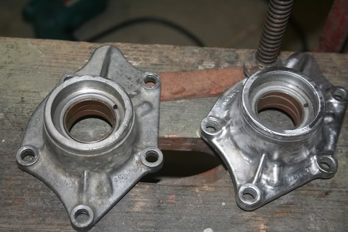

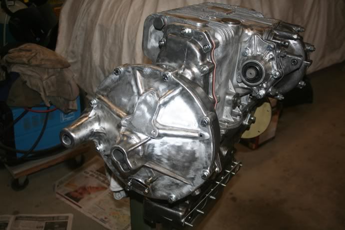

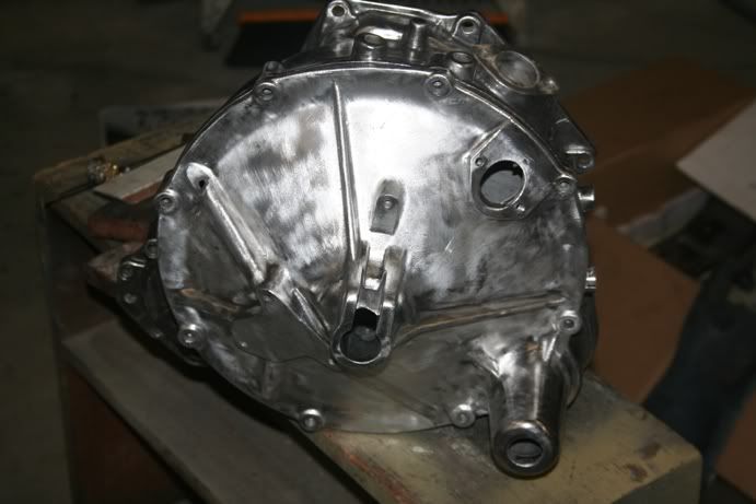

Cleaned up all the alloy parts ready for painting.
This shows a before and after shot
clutch cover
Gearbox placed onto the engine and bolted into place.
Now ready for painting before all of the ancillaries are added
