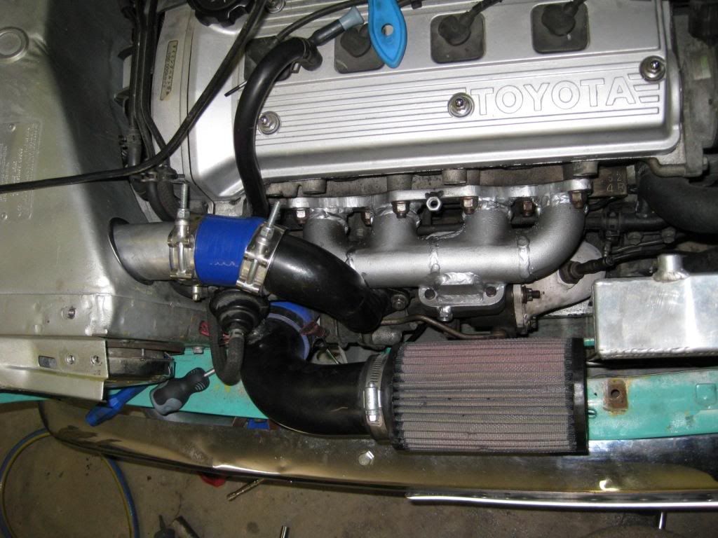

Hi guys,
its been a while since an update..
Been drilling out non critical bits and pieces to reduce some weight.. including the back seats! :D
I made a new log manifold for the car!
I've installed the SAFC and just when I upped the boost to 12psi, the clutch started slipping! :evil:
I am after a new clutch and want to do it myself..
Can you guys please give me some guidance as to what brand etc I should look for?
-max HP less than 200fwhp
- pedal effort should remain the same
Pubs
PostPosted: Tue Aug 04, 2009 8:14 pm

I wouldn't get an exedy Heavy Duty they are only 30% uprated.
An exedy cusioned button would the the best choice maybe, i've used a custom cushioned button on Dan's car and it's probably the best.
Part No.
TYK-6924 HDCB
I have the strongest clutch, 4puk ceramic button (most are ceramic now) and it's great on the track but PITA on the road. You do get used to it but i would prefer a cushioned button on the road, but on the track i prefer the button. They are on off and very very harsh. eg. My wheels spin before the car moves but just engaging the clutch.
Think of the clutch as a fuse of sorts, if you are slipping with your current clutch a stronger clutch will push this force out through the gearbox, diff, shafts, cv's etc. Which is why i broke a couple of shafts.
I've done a few thousand km's now on the new shafts with no problems. Will be taking it to wakefield in oct so will see how it holds out.

I had an Exedy cushioned button clutch on my 305rwhp R33 Skyline and it drove beautifully on the road with a very light pedal. I would definitely recommend it.
