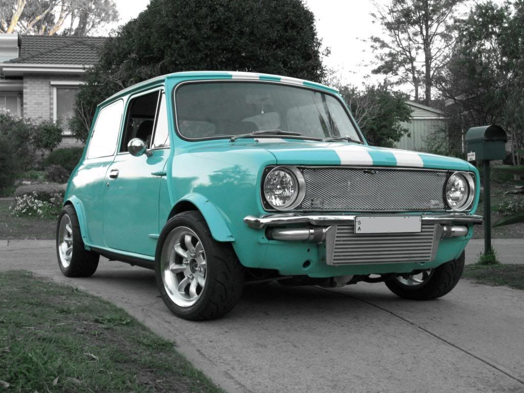

just thought I'd upload a pic of the whole car with the new wheels etc.. I bought some sportspac arches to fix on since the new wheels stick out too much!.. I don't want to get pulled over by the boys in blue.
I would probably go the KKR280 route T2 flange, cheap and known to work well.
My thoughts exactly.. if the turbo screws up.. buy another one! :D
My boost controller isn;t working properly.. takes a LONG time to build boost.. surely it can't be the wheels! :(

I Love those wheels. Tyres look hot too! :wink:

Just curious....where are your indicators and parkers :?:
PostPosted: Sat May 23, 2009 12:49 am
Posts: 953
Location: NOR, Perth, W.A.
The parkers are contained within the main globe (They look like the H4 halogen replacement headlights) and the indicators are probably the square clear ones at the bottom of the main grill.

I doubt those blinkers would be legal here in NSW, they are too far in from each side.
I like the intercooler plumbing there though! :lol:
