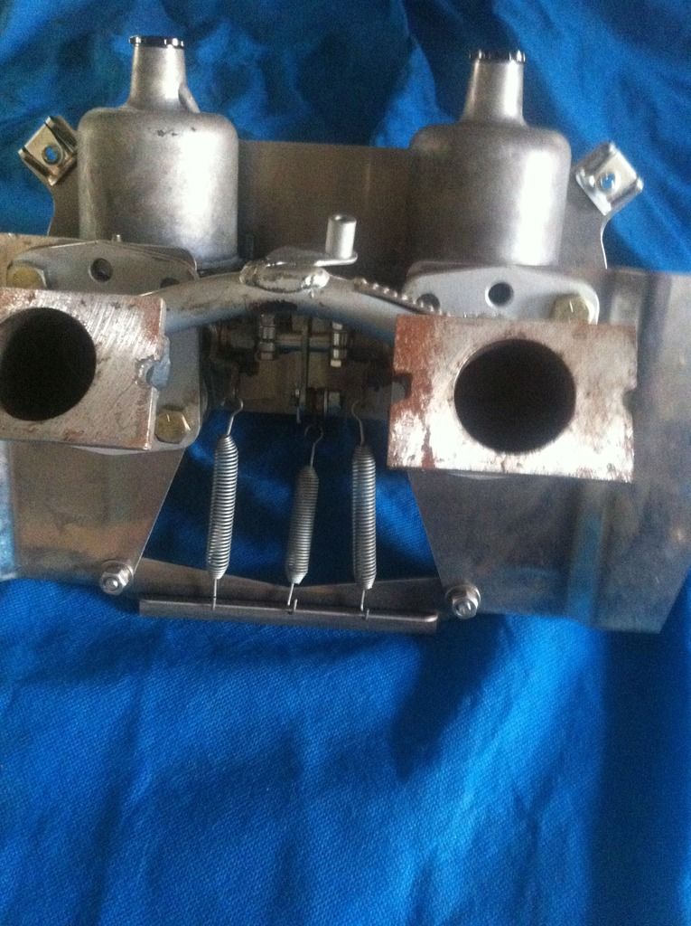

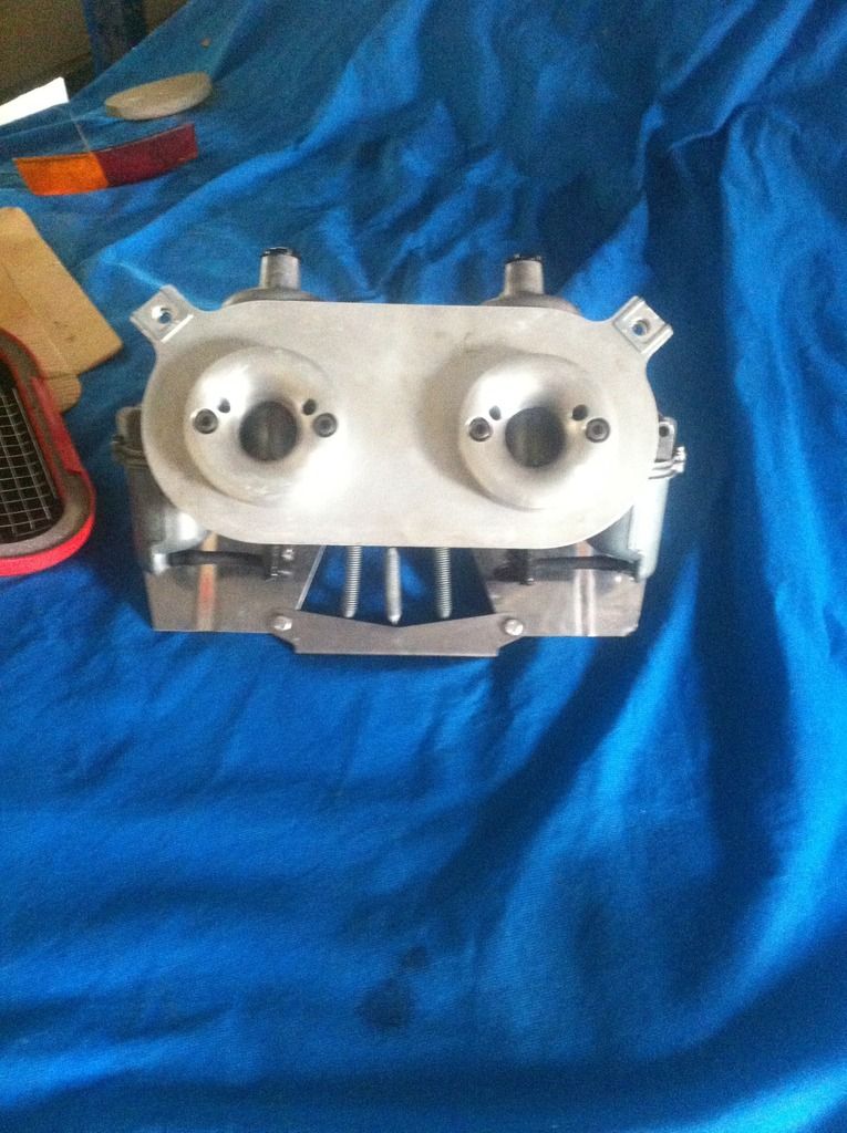

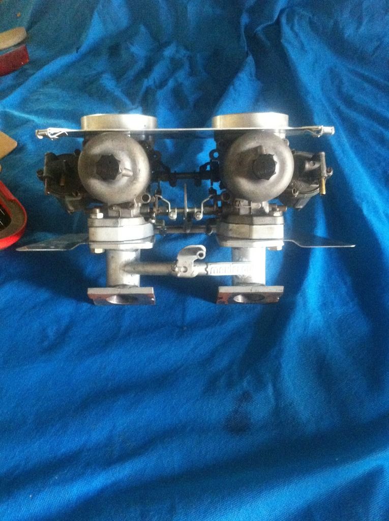

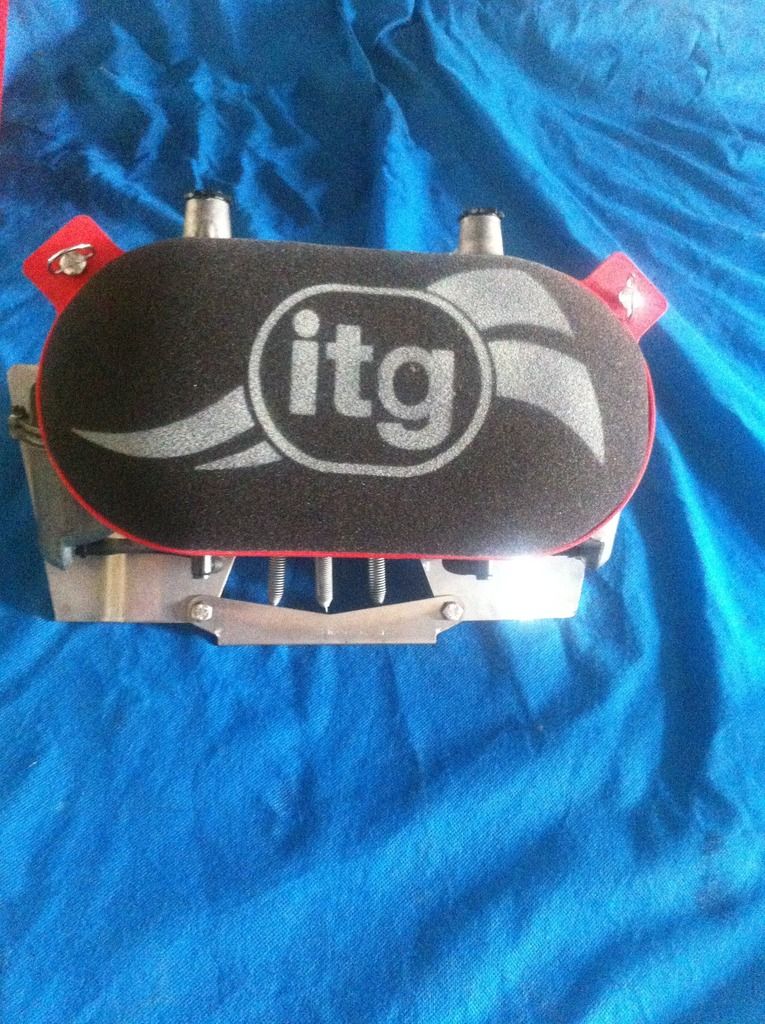

Here we go wellington kiwi,
The SU s are in need of an exterior polish but here are some photos etc.
I used an ITG air filter/ ram arrangement - quite low profile but WIDE -
the spacers were 16mm but when you put a gasket either side and a heatshield in there the 'space' is closer to 20mm.
the bottom of this heatshield where the return springs attach, is the part that wont slip down past the lip on the firewall, unless you tilt the motor forward...
The kit
Base of shield - linkage connector in the middle of the two SUs
From above
Nicely rounded entry for air
Cable attatchment and spacers
Cheers Darryl
