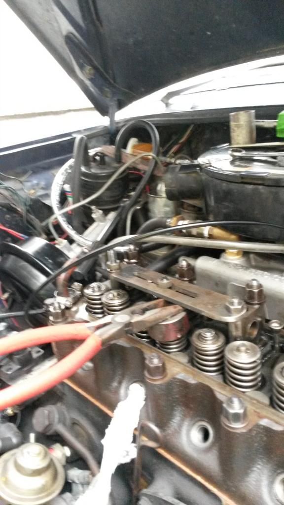

after getting the overhauled head back it was seeping a bit o oil down the front of the head, I figured I had applied the spray on sealant too thick.
Simple I say just replace the gasket.
Then it starts to drip a little oil onto the pistons when resting.
easy just fit these stem seals.
the head is NOT coming off for the THIRD time this week so did this.
the long nose pliers are for wriggling the springs so as to locate the collets.
also used a piece of 10mm key steel in place of the pliers.
then wriggled the complete assy for fitting collets
It's easy once you know how.

Snazzy little bit of metal work there diesel.

cheers Mick, hope it works.

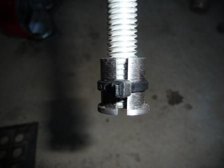

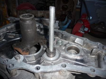

Printed off the measurements for the Doc's bush idler bearing puller and had a go at making it late last night. I'm no fitter and turner but I think its good enough.
I didn't have an o ring so I used a cable tie :wink:
I also didn't have an M12 tap so I used 1/2 bsw rod instead.
It work great. Big thanks Kev for your how to.
