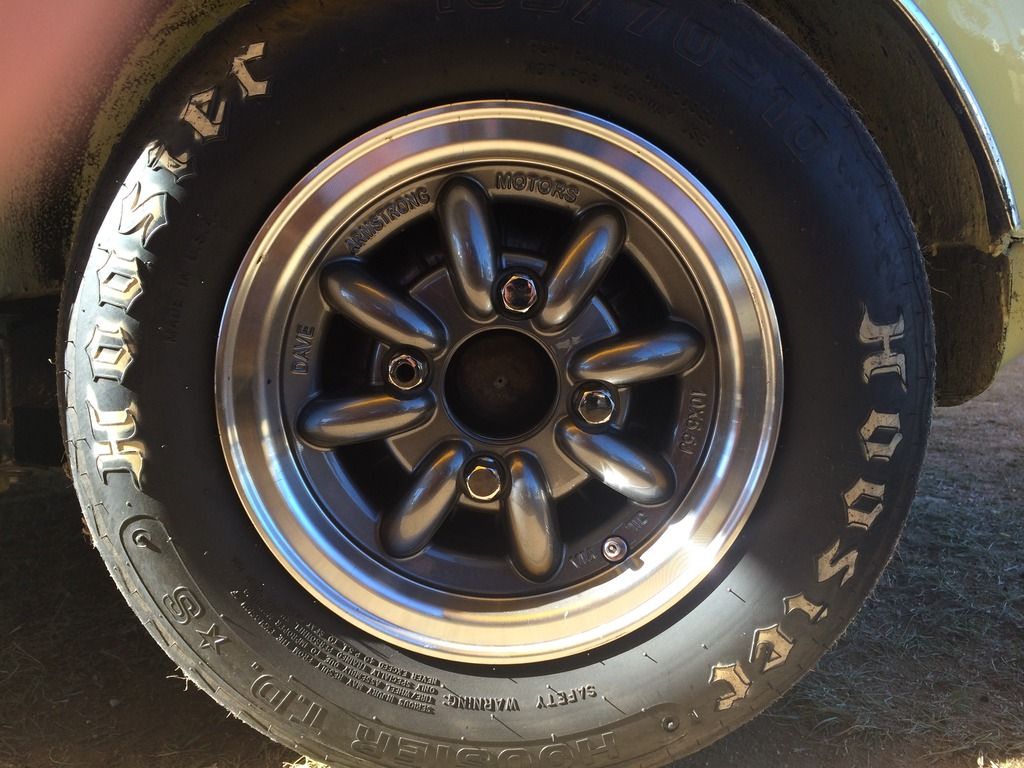

junior wrote:
Assume these are an alternative to the 5.5" wheels Dave Armstrong Motors have had made.
Here's another pic. Nice wheels.
It was interesting at Warwick last weekend that none of the Nb minis were running the Contessa wheels they traditionally run. I guess the risk of them cracking is too much these days. There were a few with these Dave Armstrong 10x5.5 wheels and the other cars were Nc class so they ran wider offsets.
It will be great to have another option for wheels when not running flares.
M
