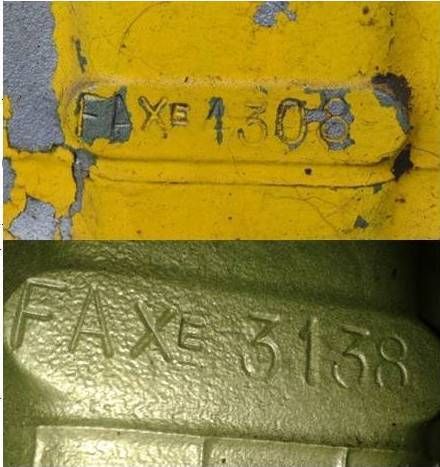

GundyGuy wrote:
Also an actual photo of what the serial number should look like
I will get a photo for you later tonight.

 Post subject: Re: MK2 Cooper S Gearbox
PostPosted: Thu May 12, 2016 7:11 pm
Posts: 5123
Location: The Internet
gtogreen1969 wrote:
Here you go.

Thanks for the photos and extra info

gtogreen1969 wrote:
gtogreen1969 wrote:
Here you go.
Do these numbers match the chassis number/engine number?
1970 MK2 Cooper S
PostPosted: Sun May 15, 2016 4:44 pm
Posts: 5123
Sorry but I don't have an answer on that one. The bottom doesn't as it has been fitted to a MK1 Cooper S engine.
