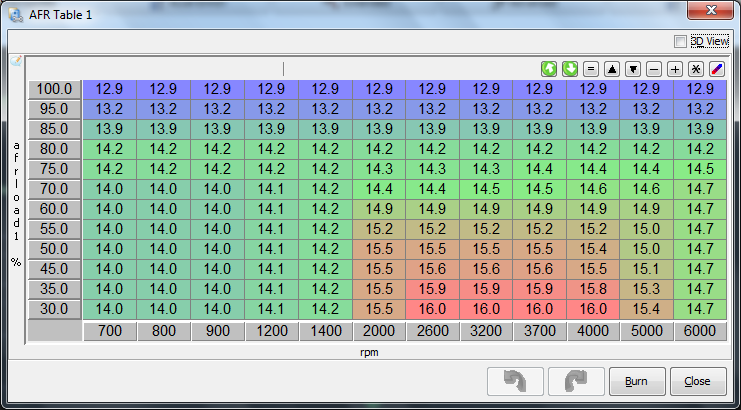

Harley wrote:
jb007 wrote:
...... 5.35l/100km or 52.79MPG for the older ones amongst us. Now to be fair, this was mainly freeway Km's between Werribee and Kew.....
Thats the same as what the 1.3i is claimed to be on the freeway cycle.
If at any point you're getting better economy than the factory, I'd be wondering if something is set too lean, wouldn't want to damage anything in the long run.
Here is my latest AFR Map. I only touch 16:1 when I'm higher in the rev range on a very trailing throttle. I've had it up to 16.5:1 but the car starts to surge very lightly, so I have backed it off.
With the factory cars I believe they don't run as lean, mainly because they are only running Narrowband sensors that only can tell the ECU if they are under or over the stoichiometric ratio of 14.7:1, whereas I'm running a wideband that can accurately measure between 10-19:1.
If I was rich, I would put in an EGT (exhaust gas temprature) probe to make sure temps are not getting to hot, but I'm not rich, so I guess I'll have to do with what I've got.
Further down the track when I've finished doing my mapping, I'll turn on the "Over Run Fuel Cut" feature. This cuts the fuel when you lift off the throttle... my little Renault has this feature and it works very well. :)

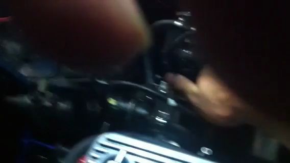

Here is a small video of my injection set up ... It uses two 33mm throttle bodys off a Kawasaki ... With RX7 injectors this is my first start up cam is Kent megadyne 296 so it's a little rich and lummpy
Enjoy
http://i149.photobucket.com/albums/s42/ ... 8ff00d.mp4

I love the sound... definitely has a cam! 8)
Are you using a MS ECU?

Oh yeah!!
That sounds sweet.
I'd love to hear that screaming through the hills on a quiet Sunday afternoon. :twisted:

I'm using a haltech F9 it's fuel only but sure is alot of fun .... Still needs a bit of work and a good tune
