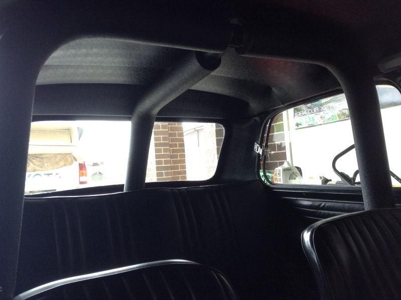

PostPosted: Fri Jan 10, 2014 2:42 pm
Posts: 780
Location: Quakers Hill
Not really a 4 point sorry but anyway
1993 R32 Nissan Skyline GTR
PostPosted: Sun Jan 19, 2014 7:50 pm
Joined: Mon Mar 18, 2013 2:31 pm
Posts: 240
alittle more info on your setup - keen on something exactly like this :)
Custom made or kit ? Where from / cost ?
PostPosted: Sun Jan 19, 2014 8:25 pm
Posts: 780
Sorry mate came with the car, no branding on it
