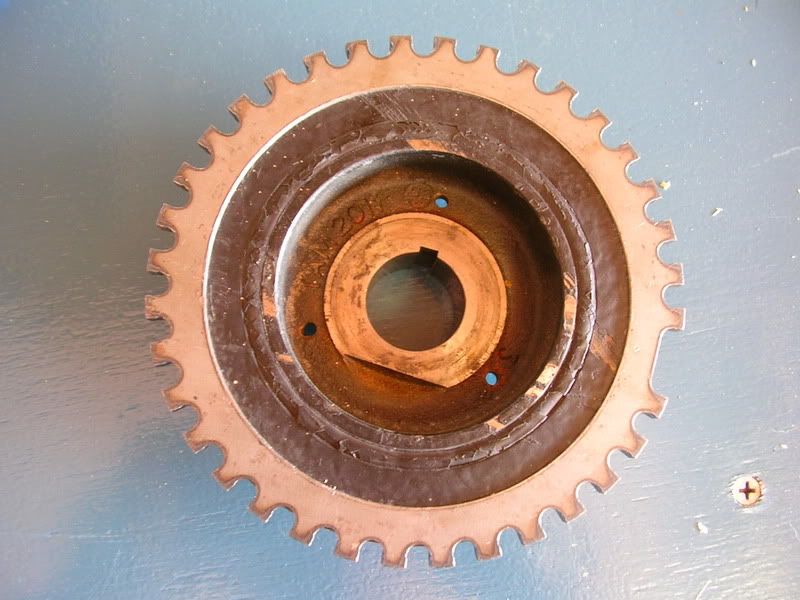

Can I ask, how did you mount the 36-1 crank wheel?
PostPosted: Fri Dec 06, 2013 2:43 pm
me or him?
after getting mine cut and machining a profile in it, I drilled a couple of 5/16 (countersunk) holes in it and put screws through it into the existing tapped holes in an 1100S type harmonic balancer
its in my how-to viewtopic.php?f=25&t=56242

Either or. I had a feeling they were smaller than the outside diameter of the wheel. But that makes good sense.

You might say I cheated - got a new assembly from MED, and their sensor on mounting.
It was the "no work" option!
Does all fit up nicely though.

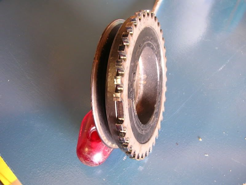

PostPosted: Fri Dec 06, 2013 3:13 pm
Posts: 1170
When i fitted mine, I turned down the outer of the balancer and then a 3 points i drilled and grub screwed the toothed wheel and the pulley together, the only pic i have though is with the wheel on but not using the grub screws yet

i just use a dividing head & machine the teeth out of the pulley
