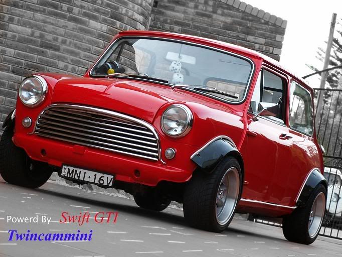

PostPosted: Thu Jun 16, 2005 8:07 am
These are 13x7's...

What a hassle, I'll go with 12s :P (The 13s where by 8, and the pic mini mad posted scared me :P).
