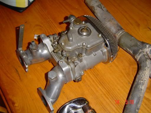

well this is it. is that a good manifold or the bad one?
and where do i get a filter like this one? and are they expensive?
http://photobucket.com/albums/v684/64morris/

I'd honestly stay with the filter you got 64, as i had to mod the firewall to get the weber to fit without fouling on the firewall...... as that is the filter i have on Slidey (Prices from $90 odd up to $125 i have seen)
Also i think that the air drawing capacity is minimized on that particular Filter :oops: :cry: .... but i put it on as it looks sweet....... ricey excuse i know :oops:
I think Pipercross and Uni or FinerFilter has been mentioned as the best choices

I hope you are thinking about firewall modifications because that is what you may need to fit that filter...

Manifold is ok,,,i do give them a tickle with the port & polish tool first tho,,,but for a mild roady 1310 you could just bung it on.
i`m not a fan of K&N filters at all really ,,, But,!!! the Ramflow one isn`t very good either (for differing reasons) , but, if you had the coice between those 2 ,,,then i`d run the Ramflow one that`s allready on there, it will "Just" clear the baulk head & won`t creat too much of an issue in tuning.

Not much room there, really- not even room for a pair of UniFilter socks, unless you stick them thru the speedo hole...!
I use a Ramflo casing with a Finer Filter foam in it. Good, but now NLA. Maybe UniFilter (who bought out Finer Filter) make pads for them now. I dunno- they won't answer messages sent to their website.... :evil:
