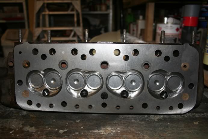

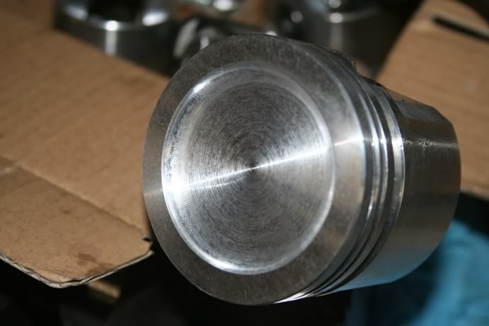

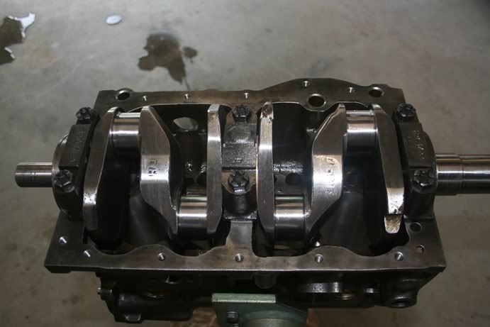

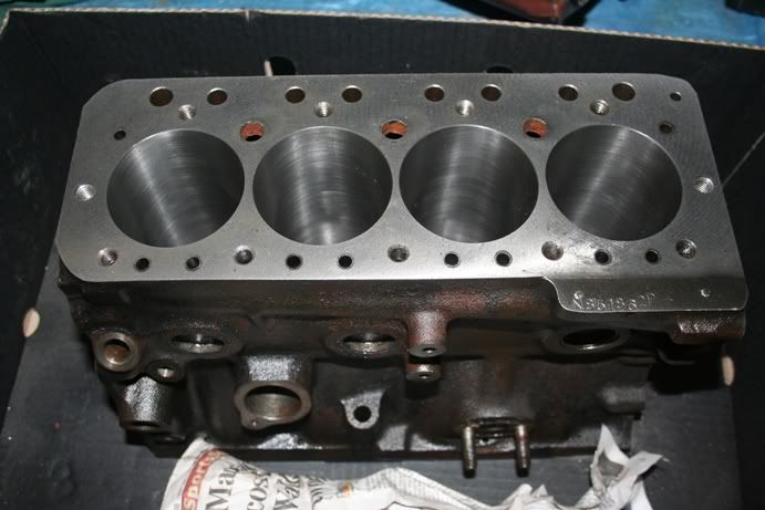

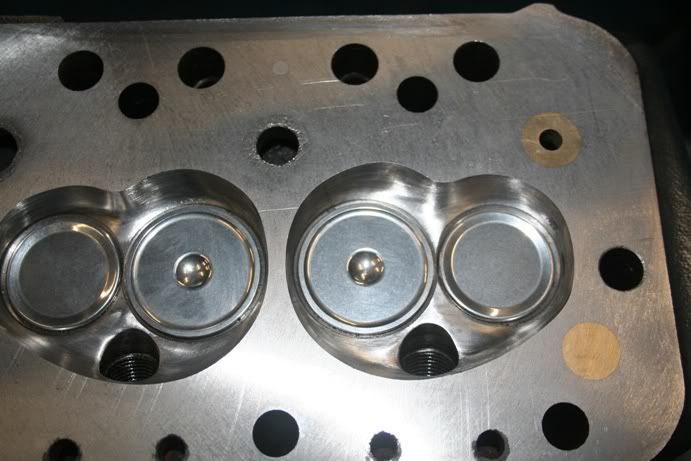

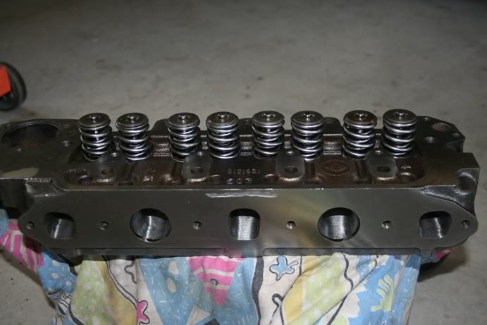

I am now progressing very slowly with my Supercharged engine.
Engine has been all machined by GR and new pistons supplied.
Head has been ported and Rimflow valves fitted
Camshaft is RE83T
I have started to re assemble the engine
