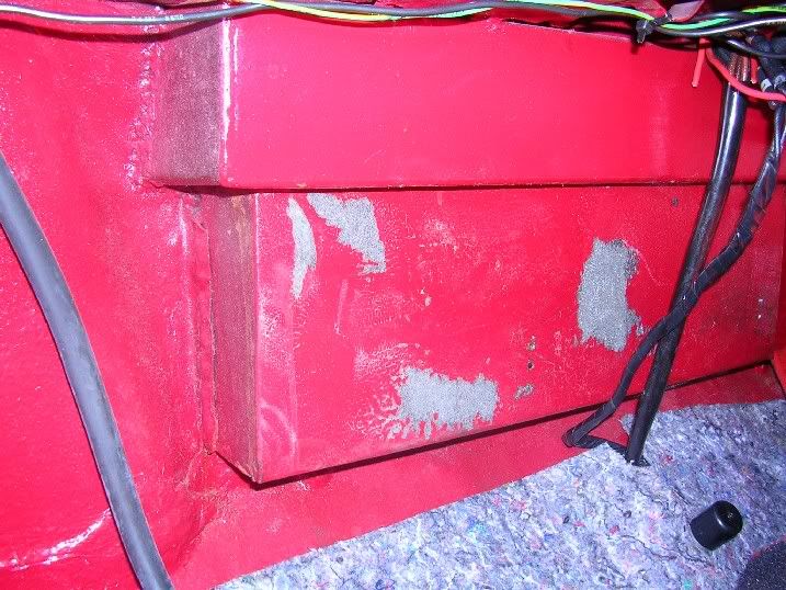

Cutting that box in there and engineering it is not just a case of seam welding it all round. There needs to be bracing around the box in the cabin, to restore the body stiffness lost by cutting it out...!
Talk to Boostedmini... :wink:

Kev is right the only way i got mine engineered was to make this brace on the inside.
