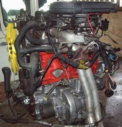

PostPosted: Fri Jan 06, 2006 2:27 pm
Posts: 2495
Location: Vegus, Brisvegus
A SPi motor needs the oxygen sensor in the exhaust. Minimania sell LCB extractors with these fitted but you can convert standard using the an M18x1.5 nut (check, its the same thread as many spark plugs). The sensor is quite big and could restrict flow, even if you position it at the Y in the pipe.
It is illegal for you to remove the cat converter if you have a post 1986 mini BTW.
The standard cast manifold and twin down pipe arrangement in the SPi cars is not too bad. See photo. The sensor is in a pocket in the casting so it doesn't restrict flow.
