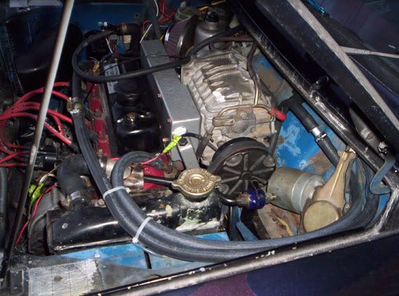

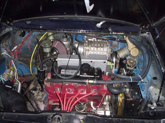

Hi all, well some wanted pics some wanted audio, Ive managed to get the first part done with my girlfriends sisters digital cam, ill get the audio bit done as soon as i can.
so here it is
SO now all thats left to do is sort out the high idle speed, i suspect its the choke not being able to close full because of the new cable position, and then its off to the dyno for a decent tune and run!!!
Once again thanks to 92 for his kit, its a top piece of work!!
trent

Job well done :wink: Now all you need to do is conceal it all from the boys in blue..... and neaten up that wiring :lol:
PostPosted: Wed Oct 26, 2005 1:10 am
Very neat installation 8)
PostPosted: Wed Oct 26, 2005 6:48 am
Top one Trent and congrats for get to stage one.
looks like a close fit for you and I bet thier are a couple of sore fingers thier to
I musta say I would love to hear it going and the Dyno stat's
I cant wait to give this a go also :wink:

Thanks guys, yeah it is a tight fight, i had to actually move my wiper motor over as the engine steady was hitting it, and sore fingers, dont get me started!!! The worst bolts are the 2 manifold bolts that are right under the unit, you can only just get the 1/2 in spanner in there and turn it about 1/8 of a turn each time so it takes quite a while and hurts, especially your back. My left forearm is so bruised it looks tanned haha!! All worth it in the end!! And yes the wiring is a bit of a mess but has been tidied up :)
once the dyno is done ill let post some stats and what not
trent

how close is it to the fire wall and the cross member..specialy with the steady bar :!:

it looks closer in the pics than actaully is, i can fit 2 fingers in between the charger and firewall, and the engine steay is angle so it clears quite well!!
