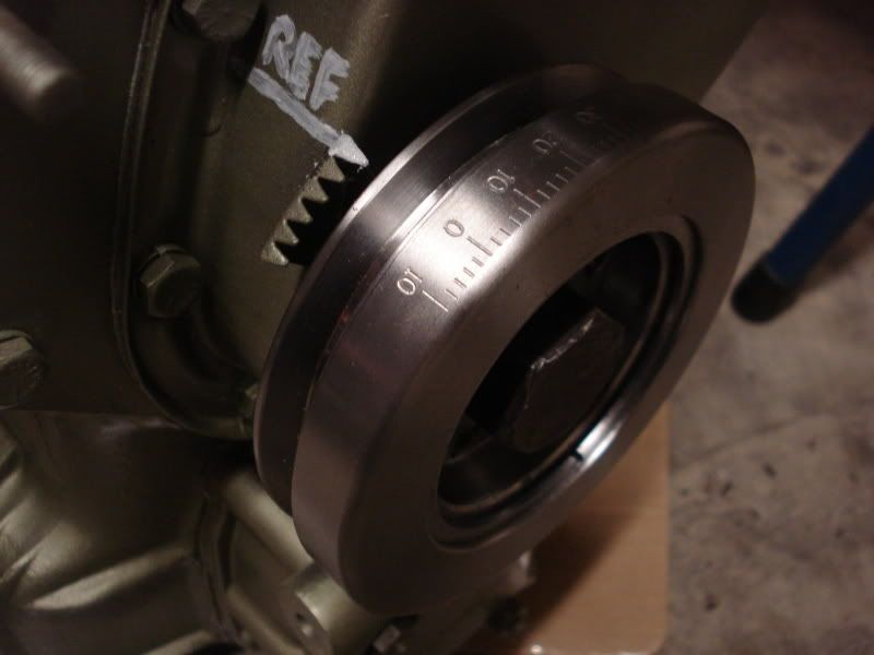

Gratuitous ROMAC pictures for your pleasure, they are pretty aren't they when new?
This one's on Skender's new donk.

Mick wrote:
BTW
Mick is that the steel centre type or all alloy type......They do look awesome and a very good unit.
PostPosted: Sun Aug 09, 2009 7:27 pm
Posts: 18888
Steel I believe, Skender picked it up once it became apparent his original type was cactus.
PostPosted: Sun Aug 09, 2009 8:20 pm
Romac only do all steel or alloy with a steel centre, no such thing as an all alloy Romac HB
The alloy/steel units are fantastically light though compared to an "S" unit
I must have been misinformed then or they were misinformed and passed on the incorrect information. The first few I bought I was told that they were alloy centre and alloy weight/outter ring and when I picked it up it was very light and the metal finish looked much the same on both parts.
Anyways thats niether here nor there really, I think they are a really good product and will keep using them, especially on non standard engines.
