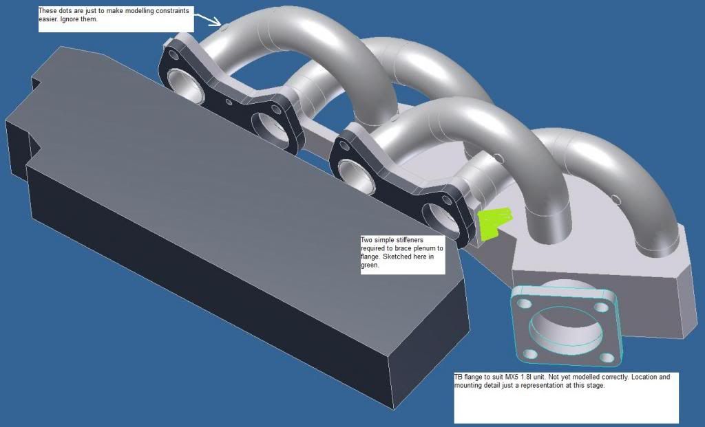

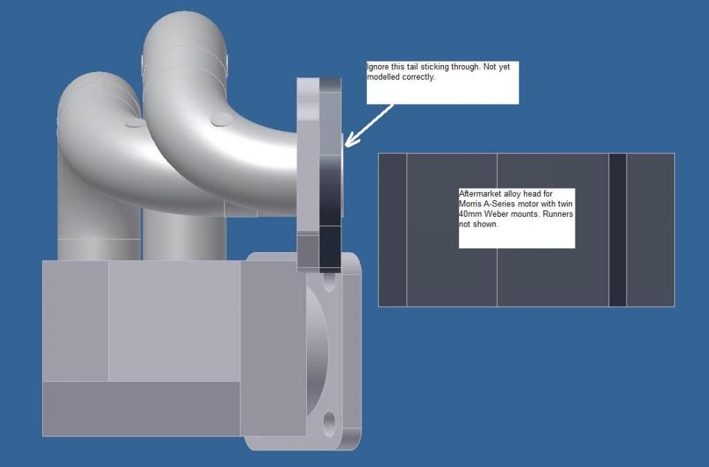

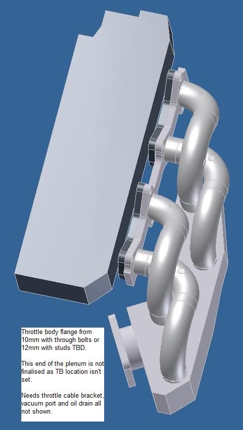

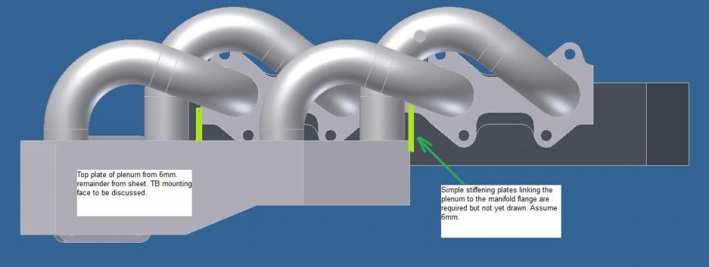

Another year has gone by and I have been too busy with work and life to make any progress.
During the year I did get myself another mini though and that has enabled me to make better measurements of what will and won't fit under the bonnet of a round nose mini.
I have decided that I can (1) use short series injectors and put them in the head or above the runners or below the runners. (2) use standard injectors and put them in the head.
Putting standard Denso injectors in the head is possible without any welding, just machining of a flat surface around the hole for the washer to seal against. I like that idea and will run with it. 14mm O-ring injectors would need the bosses welded to the head. Not impossible and could be done even if the head has already been machined to take the Desno injectors.
With the injectors removed from the inlet manifold, the possibilities are far greater. I have designed the one shown in the pictures below. It will clear the alternator, distributor, oil pipe (not cooler hoses that stick straight out), the bonnet stay bracket, dip stick, bonnet catch and the headlight bucket of a Moke. It will allow an oil cooler to fit below it.
It has enough room for the plug leads (just) but changing plugs will probably require taking the manifold off.
The coil and starter solenoid need relocating.
I won't clear the widened slam panel of a Rover with remote bonnet release. It also puts the throttle body in a spot that would clash with the remote brake booster fitted to an S or similar. It may allow fitment of a Rover style MC and booster unit.
I haven't finalised the design where the throttle body mounts. I think I will mock up something out of foam or timber to really get the TB in the right place. My car has the brake booster fitted so I can't easily do this bit.
I have sent these images off to a mate to get advice on how much it would cost to get fabricated.
All runners are equal length and are 260mm (10 inch) along the centre line. All runners are 1-1/2 inch OD (38mm).
Hopefully 2013 is the year that I can get this thing going.
