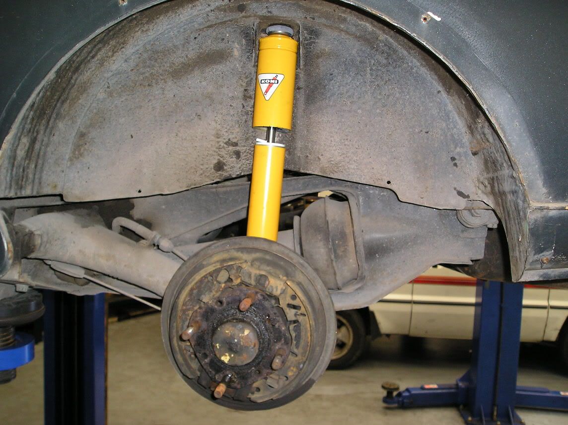

By no suspension i mean that i have no shocks on the car, every thing else is still on there like the hub and brakes. How do i add a pic and i will add some so maby you can see what i mean....

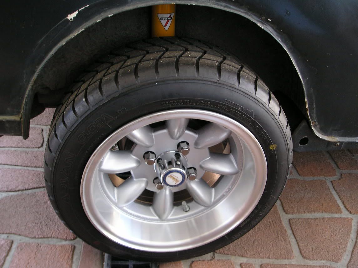

These links as follows has some pics of the van with the suspension on
and without it, the pics with the bodykit is the pic without the koni's on,
and obviously the others have the koni's on.. See the difference in ride
hieght? And there isnt much difference in height between the 13"s and
the 10"s as the tyres on the 10"s are taller

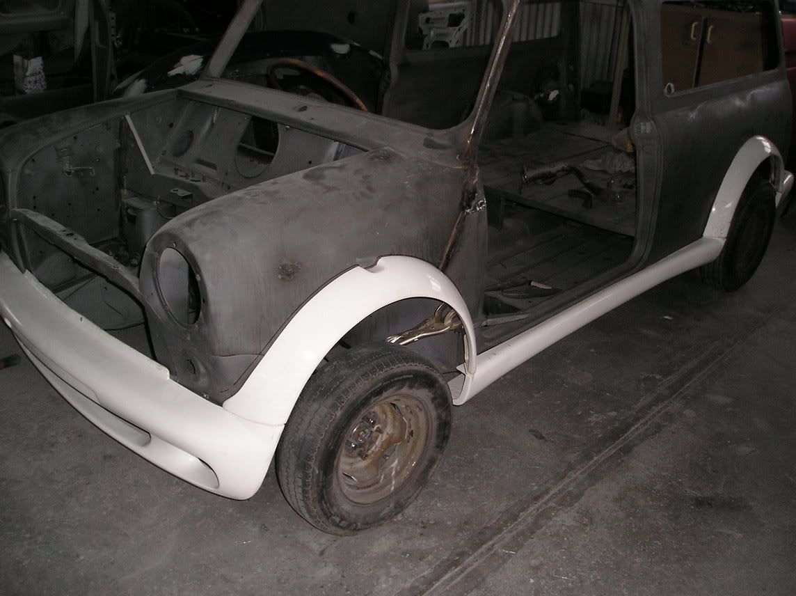

dude, what do you have the multi-grips holding??? and that is a big gap!!!!

Yes that big gap is the dilemma that i am faced with.. And the vice grips are only holding on the kit before it was screwed on. And that height of the car is without shocks on, so it must be sitting on the bump stops, is it hard to remove them? And is it legal?

The Shocks don`t hold the car up ,,,& have absolutely no bareing on the "ride height" of the car,,,you`d best fit a set of """HI-LOS""",,,adjustable alloy cones,,,these will enable you to set the ride height where you want it to sit.
& yeah,,,as Greg said,,,a major portion of what i was saying about 13" wheels compared to 10" wheels is to do with the un-sprung weight,,,very hard to find a 13" wheel/tyre combo as light as you can get, to come anywhere near the weight of a very light weight 10" wheel/tyre combo & yeah, split race 13" wheels & canvas tyres are very light,,,but simply not as light as split 10" race wheels with canvas bags :-) simple as that...

When i had the suspension on there, me and a mate jumped in the front on the sub frames and jumped up and down a couple of time and still didnt seem to drop the car that much and the total weight of me and my mate is about 215kg or so....
What am i expecting to pay for a set of hi - los? do they come as a set of four? for the front and back or do they come in a set of two?
