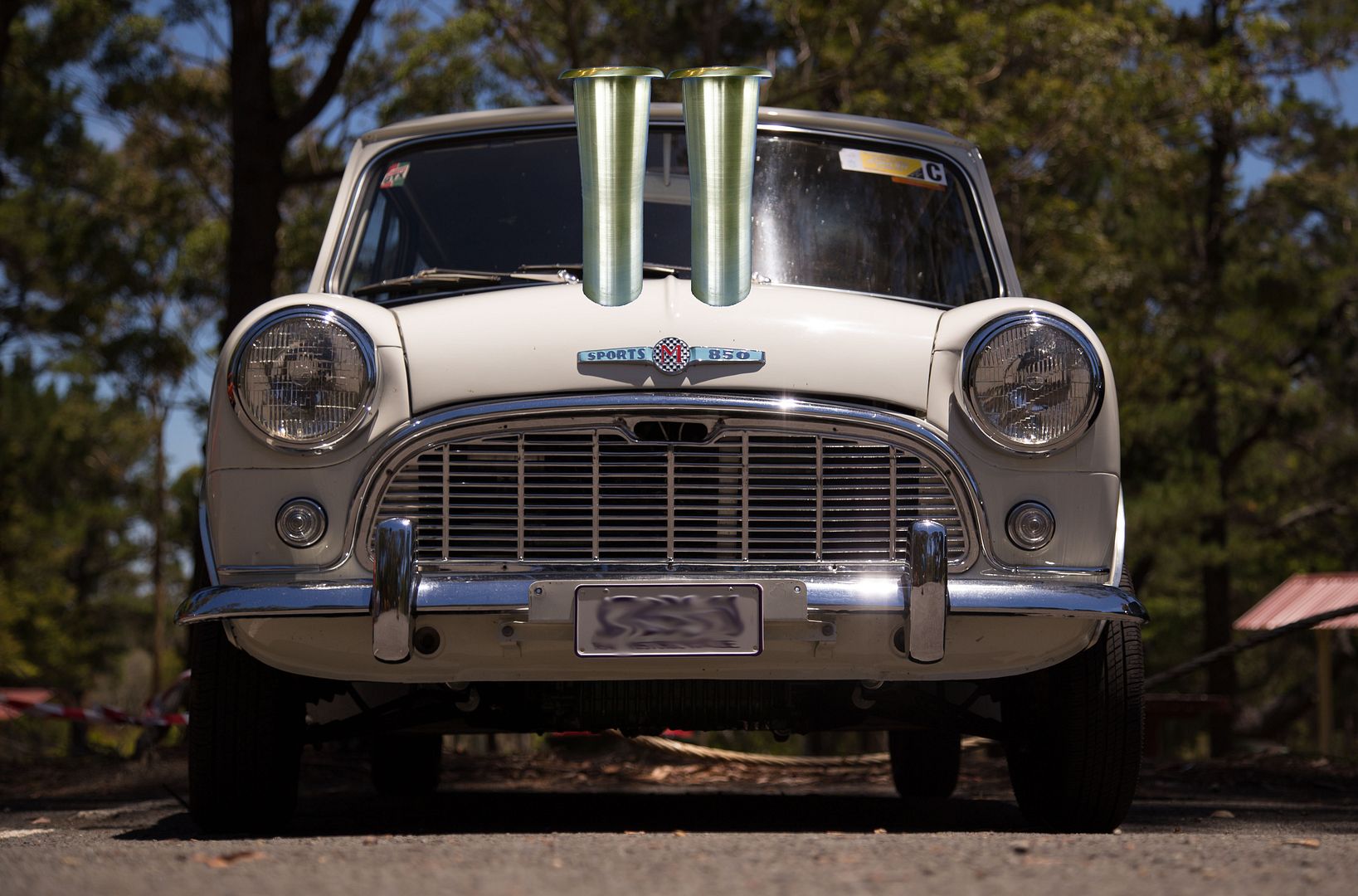

You must be loosing your memory and eye sight, when I first showed the set up to you I explained to you that it only had about 30mm clearance to the bonnet and I have stated on this forum that it only had about 30mm clearance.
Having sold 16 of these now no one seems to be concerned about air cleaners but you, even the guy in South Africa doesn't seem to be concerned as he is running two ram tubes about 8ins long out of the bonnet, but this is good because he will not suck any rubbish or wild life from under the bonnet :lol:, then again if he sucks an elephant down the ran tubes it is easier to stand on the bonnet and lift the elephant of them, but it,s going to be a helava job to get him out from under the bonnet specially if his trunk got sucked into the cylinder :shock:
The motor in my LS has ben in there since 1993 and never run an air cleaner but I don't go driving on dirt roads, but it has been run in regularity events at race meetings and has done track days and still going strong after 60000 ks, may be if the air is that dirty we should all be wearing air filters on our face

Is it kinda like this
:D :D :D

Nice one Aaron
Did you have to park it under the trees ? now we have to watch out for BROP BEARS.
