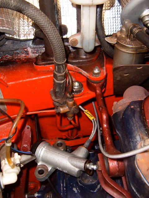

With the chances of getting on the road improving, it was time to sort out one or two other minor problems. First and foremost was the rock-hard clutch. I'd asked about this problem a week or two ago in another thread and the general consensus was that the clutch hose was rooted. I'd bought a set of braided hoses with the Mini Spares order, so there was a brand new item ready to go on. First, the old one had to come off...

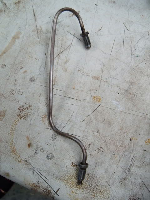

This is the love/hate relationship I have with Mini's. Not nearly enough space to get tools into position without removing half the engine first. First I had to get the clutch pipe off in order to remove the hose.. that was bad enough. This hadn't been off the car in the 12 years I've owned it, so you can imagine the state it was in. In the end it came off intact, and 2 minutes on the wire wheel later:
Once the pipe was off we could get to the hose. That came off easily and as expected, was almost totally blocked. On went the new braided item, on with the pipe, a quick bleed and and Oh My God, what an amazing difference. If there's a better clutch pedal feel in a Mini, I want to see it 8) 8)

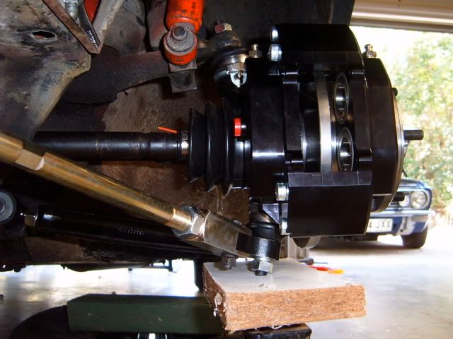

So with the caster bars set to standard length and 1.5 degrees negative camber on both sides it was off for the first road test. There were no problems at all with caliper clearance to the rest of the suspension or the wheels. Don't know what Mini Spares were fussing about, it's all good 8)

Another cow of a job, that one. First I had to drill the backplaces to take the 'S' cylinders, as they have the locating pin on the other side to the 3/4" cylinders. Next, I very nearly cross threaded both pipes when refitting them because they wouldn't sit straight in the cylinders. A couple of hours, much swearing and bleeding fingertips later, they went on straight, thankfully.

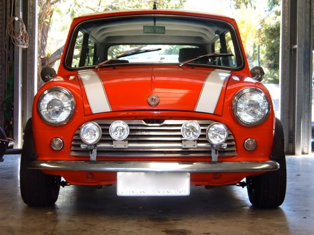

So that's about it. It took five long days, but we've successfully converted from drums to slotted, four piston alloy calipers and fully adjustable suspension. This is the end result.. 2 degrees negative camber looks mean:
I still want to get a proper wheel alignment done, but after a couple of hours on the road today it feels like it's probably not necessary in the short term. The car steers and stops better now than in any other time I've owned it. In hard cornering, the front end bites and sticks, and the tail drifts every-so-slightly. Muuuuucho fun factor :D :D It's also heartening to know that the brakes are only going to get better as they're bedded in 8)
Anyone who like me has been wondering if this can be done -- the answer is a resounding 'yes'. 4 piston calipers clamping 7.5" brakes under 10" Contessa's -- it fits, it works, brilliantly 8) 8)

Are those Contessas the std Mini offset, or the LS offset (less track) ones?
I doubt the 4 pots would fit in the latter, S calipers usually/often need a grind near the bleed nipple.
PostPosted: Mon Oct 01, 2007 9:33 pm
This space for rent
Posts: 5455
They're the standard offset, not LS.. and there's not more than 2mm clearance at the back of the caliper.. :shock: :shock:

Those calipers must be Phat then, I have miles of room with S ones... :lol:

excellent... I remember my old wide offset contessas over S calipers scraped on the balancer strip that was inside one of them.
Get that little sucker back to Melbourne so I can try my alloy S wheels on those brakes - what's the ETA?
I swapped my rears to the front on the weekend and had to knock the balancers off the inside of them as they hit on the caliper - lots of clearance otherwise so I'm confident!
