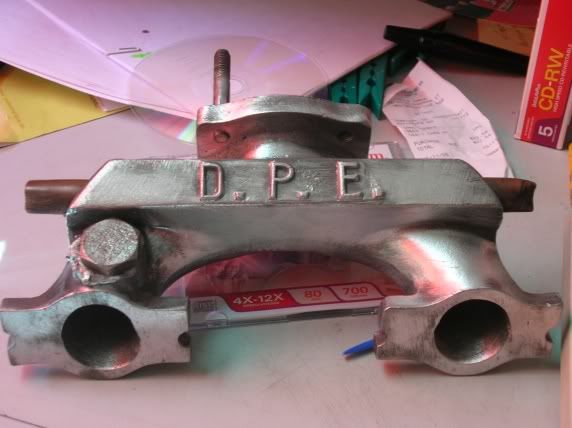

we are using a DPE manifold. I tried to find some information on them but no luck. I dont have any issues with firewall or cross member but I think they been given some adjustments
PostPosted: Wed Jan 13, 2010 9:53 pm
Posts: 1550
D.P.E............nup, got me Gaf :) ""looks"" good though.. (from what you can tell from a photo :) )
Obviously you like it yeah? How did you come to get it? I can't find anything on them either :?

Looks like a copy of the Oselli manifold... :)
@PK:
If everything fails; adjustable top engine steady? :)
My MG manifold was a bit of a downer... Casting was very rough and missaligned, and it had only a 1,6" opening :shock: Took me some hours with a grinder to get it right. http://img146.imageshack.us/img146/5628/hifvergl.jpg (left pic) But most other I've seen have a very good finish, though :) Still like it, my prefered manifold. And I think the MiniSport and new Spares manifolds are more or less good copys of the MG one.

IMO if a manifold doesn't flow well there's no point using it.
The GR manifold outflows all the others hands down, it is worth the slight body mods needed to make it fit.
As Asphalt says, an adjustable steady would add a little room, if you are NOT running a remote box.
Here's how it fits in a stock `77 Clubby body (stock steady) with an HS6 attached-
With an HIF44 things get tighter- see how the carby is sitting high, because it's touching at the float bowl. The firewall would needs a heat & good thump with an XVBFH, earlier bodies need cutting as Aaron found out.

Most water heated manifolds were designed for UK use, where winter temperatures cause problems, not really needed in Oz. In fact it can lose torque if connected as the cooler the inlet charge the better.
DPE could stand for Dave Price Engineering who did a lot of work with BL products in the late1970s including running the first works SD1 race cars in the British Saloon Car Championship around 1979-80.
