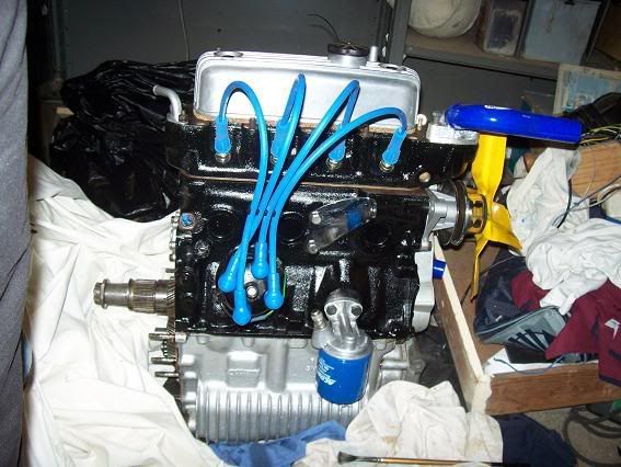

hey people soz been gone but my net has been playing up real bad with the rain so i havent been able to connect.(in goulburn we kinda stand outside watching the rain haha) but also the dial up woes :S
ok umm yeh what i was thinking of doing was getting the head slightly ported, bigger valves, upgraded double valve springs, some roller rockers if i can find some(also some lightened push rods as the ones i got with the engine are too small indicating from an 1100 or 998 prob) ill be running a decompression plate.
also i am currently running a 13 row oil cooler but have been thinking of upgrading it to a 16 row maybe even a 19..
my gearbox better hold it cause it is a race spec remote change with straight cut gears with lsd and upgraded synchro's and bearings etc with 3.44 diff but i also have a 4.11 (all brand new never been ran yet either)
cam i will replace it with a re-13t if i can get one and keep the 649(will come in handy for sure) or maybe someone will want to swap for a excellent cond one??
umm ign. most likely be doin a swap of my mk2 cooper s for a electronic setup.
cooling.. i have got the blue silicon radiator hoses and will either be getting a upgraded 2 core or 4 core.. i was told to run 2 core in the round nose and a 4 in the clubman but yer..
also i have a plastic exp. tank at the moment but is being replaced with a chrome one that i have sitting next to me as i type now lol
as i said i am spending alot of money on this but i am also trying to avoid 'wasting' money so yeh..

this is a basic engine\gbox spec
fully rebuilt 1310 cooper s short motor. Cooper S 1310
short motor, 40 thou dished forged hepolite pistons,
40 thou under big and small ends freshly ground and
hardened (nitrided) crank, strengthened centre cap,
new bearings, lightened balanced con rods, new hi flow
oil pump, set of lightened and balanced pushrods.
649 cam, converted to a cam belt drive(, Cooper S distributor, lightened
balanced flywheel.
head - std 12g940 with cooper s valves but will be redone very soon :)
fully rebuilt gearbox. Lots of work done. It has
“the works”: Mini Mk1\2 remote change gearbox, three
synchro, straight cut, close ratio, LSD - limited slip
(off set pin) diff, 3.44:1 and 4:1 diff ratios (comes
separate), central oil pick up, rebuilt with all new
bearings and seals, Cooper S steel Hardie Spicer drive
shafts
also bought set of 4 spot callipers and vented disk setup with chrome brake booster to stop me :P
PostPosted: Sat Jun 16, 2007 12:16 am
Joined: Mon May 21, 2007 10:24 pm
Posts: 42
Location: goulburn
just sitting there waiting for some parts to be found so i can finish pulling my old one out for the upgrade..
