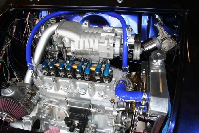

Fitted the engine into the car. Was a tight fit and took a few in and outs to finally get space beside the radiator and the engine mounts lined up but all good now.
Looks to be a tight fit under the bonnet but will need to wait a few weeks before I can tackle that issue.

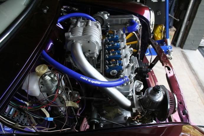

PostPosted: Tue Jan 03, 2012 2:34 pm
that blower actually looks quite small when its in the engine bay - I thought they were much bigger than that
looking good :)

There are a number of UK supercharcher kits and I think the VMAXSCART kit which I have purchased does flow OK. The inlet from the supercharcher is biased to one side so the flow into both head ports is equal.
GR checked it out and didn't say any thing too negative about the kit
The main concern I have is the long input from the carby which ices up
