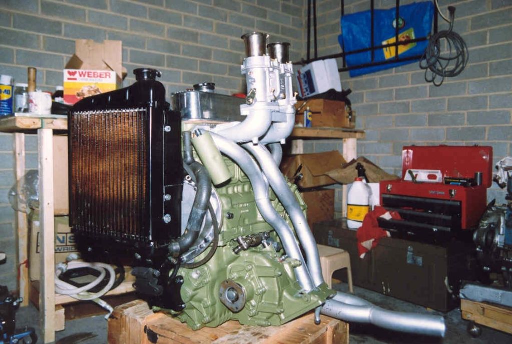

My 45 weber 1411cc had 113 lb/ft peak at 5000rpm and 127hp at 6500 on the same dyno, but more importantly, it had >100 lb/ft from 3000 to 6500 rpm. From 3500 to 6000 rpm it had >108 lb/ft. I consider that a very flat torque curve and it just pulls like a train.
Would a SU have been better? I don't know, I did not try it. But at least it destroys the myth that a Weber (or Dellorto) is only tunable for a peak power at a particular rpm or very narrow rev band.
