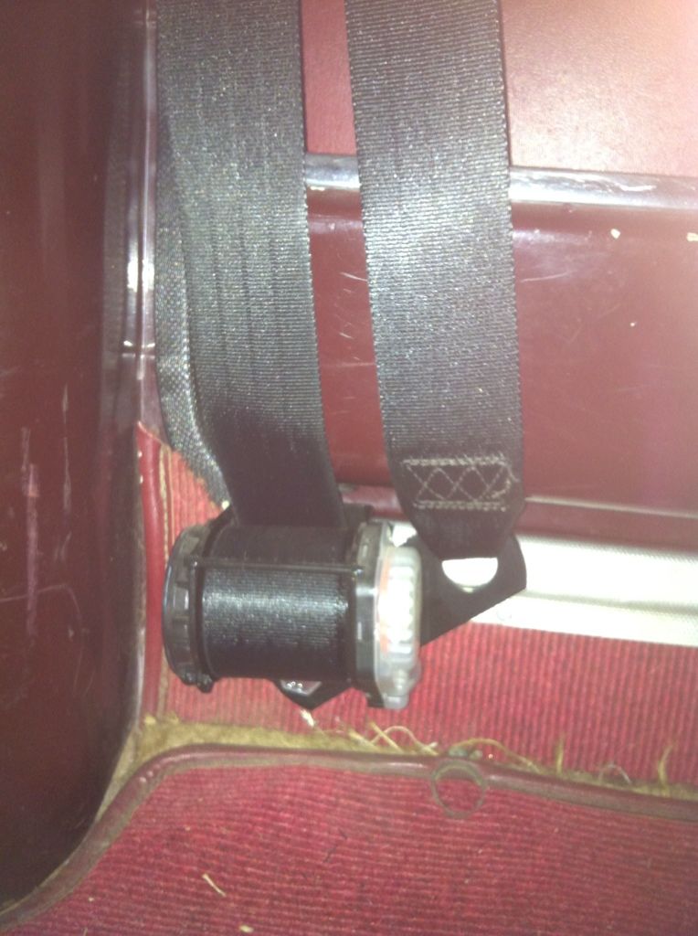

Klippan retractors, I originally bought them from MiniKing a couple of years ago.
I think would be this one with a tunnel mount stalk. Not sure what belt length though. Probably Short or standard.
http://www.selectgear.com.au/admin/uplo ... H_BELT.pdf
Door pocket clears no problem. Note reel can be angled back slightly so webbing lines up properly with b pillar mount.

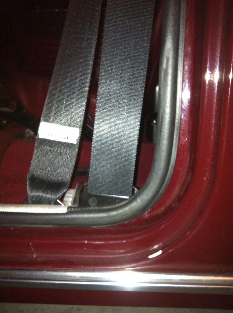

I've got the same as Phillb above. These work no dramas, and don't foul the door pocket. I also found it necessary to bend The black metal bracket the belt runs away from th door to help it clear.

i also have the same in my 71 Clubman, i mounted thenm the same as the photo just with the bracket horizontal. i found the Tombstone seat were a bit wide though...
