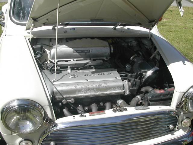

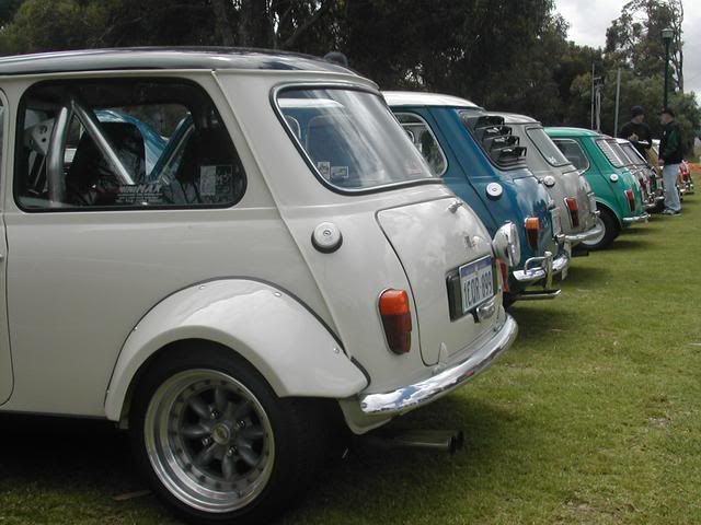

There is a car in Perth running a later twin cam 20V, but it was built in the UK and imported later. Not sure you could build it here and get it registered as the track has been majorly widened.
The Sydney car had a 4AGE engine adapted to fit a normal Mini gearbox and I'm pretty sure it was a dedicated track car.

The only one I know of here is Warwick Agustin's sports sedan Mini, it has a 4AGE, chain driving into a Mini box.
It's been running for years, doesn't seem to be too unreliable.
PostPosted: Mon Apr 12, 2010 4:14 pm
Rich's car is awesome! His username is 4agecooper on here.
Late last year, I was talking to a guy at the Dept of Transport about approval for my 4EFTE conversion and we got talking about Rich's car here in Perth. The guy said that it was "touch and go" to whether they would allow it to be regsitered due to the massive increase in track (due to the big gearbox). It was allowed mainly because it was an import but was told they would never allow one to be built like that locally. NSW may have similar laws about not widening the track too much, let alone ~5 inches!
