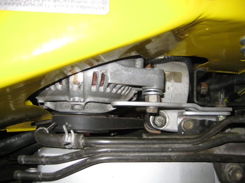

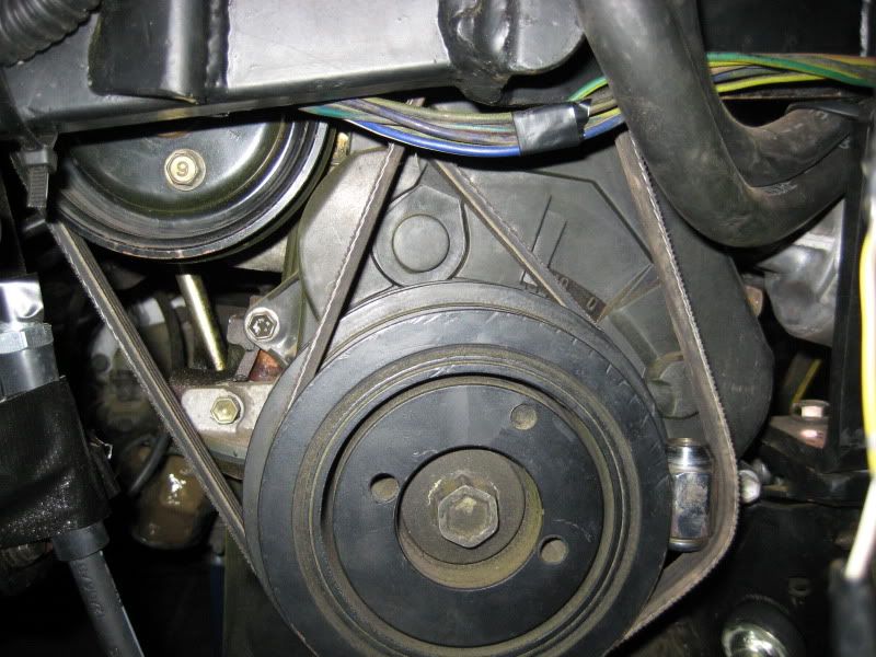

This is about as good as I've got:
I'll have a look through my photos for a better one.
What specifically do you want to see?
*EDIT: A couple more- (not sure if these will help or not.)
(like my belt tensioner in the last pic? :wink: )
-James.
Toyota 4EFTE Powered Minivan.
