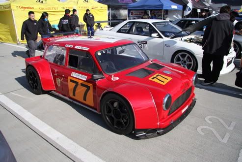

so if it were front wheel drive could i build something like this?
or something similar in a space frame.. if it means it wont be classed as an under 2 litre car it doesnt matter, il just have to put a v8 in it or something :lol:

These are the most relevant rules when looking at that pic.
Mini is eligible, no matter what age, because more than 5000 were built worldwide. There used to be a rule that any car manufactured prior to 1980 had to have the same wheels driven as it came from the factory, so for Minis this meant you could not make it RWD. Not the case any more.
The Mini Sprint as a sports sedan is only eligible if given specific approval by CAMS as there was not more than 5000 of these made and they do not comply with 3.1. This rule would also discount a lot of the UK and Japanese spaceframe cars because of the core body shape changes, like the rake of the A pillars in the pic. I daresay this would only become a real issue if you started winning.
The flares on the one in the pic do not comply with 3.4.
Your idea of laying the engine back behind the axle line works as long as you comply with 4.4 (ii).
