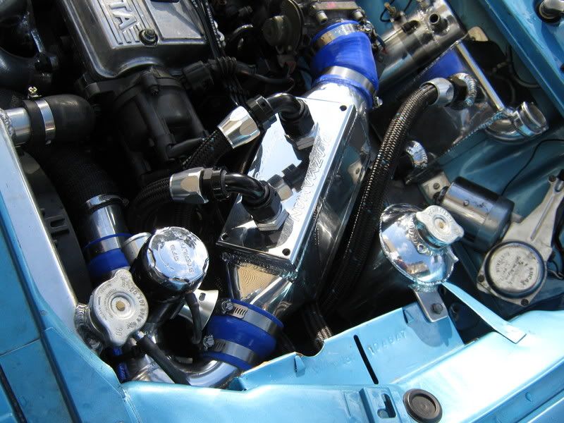

I was having problems with the PWR barrel in the car. The main problem is the surface area, being round they waste a lot of area that can be gained if you made it a square and the core is not very well designed. Plazmaman are a local company not far from where i work and i called them up and spoke to Alex telling him my issues with intake temps (it was rising up to 50+ degrees) and after some discussion about my setup he assured me that with their barrell i would see intake temps drop and also said that i would get zero pressure drop through the core!
They have only just released them earlier this year and as PWR are a competing product they were very interested to see how their product would compare and were very accommodating letting me work on the car and do the install and gave me a good deal on the W2A cooler as well in exchange for some feedback.
This is the end result:

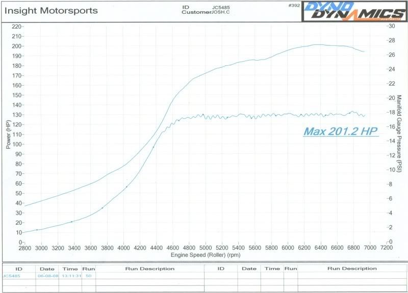

After that i got the car dyno'd at Insight Motorsports who have done all my tuning and the results speak for themselves with just this change and an adjustment in tune it made 201.3HP on LESS boost - 18psi with intake temps dropping to a stable 37 degrees.
While it was there Scott also setup launch control with anti-lag (spools the turbo up before launch by dumping fuel into the exhaust manifold) and we also have staged gear/speed/rpm/tps based boost tables added as well. So first gear is 10psi, 2nd gear is 10psi until you hit 70km/h and then it gradually ramps into 15psi and 3rd and 4th are set for 18psi.
When i go to the drags next we will make minor adjustments after each run with the aim of getting consistent times and dialing out the wheelspin.
Here is the dyno sheet:
All i can say is wow and the SMS i got when it was ready to pick up says it all "Your car is mental now." It feels so much more alive and is much more spritely and happy to rev breaking traction in 3rd with ease :shock:

A lot of the drag guys are going from PWR Barrells to Plazmaman W2A setups and seeing great improvements on 1100+HP motors. Some where they had two PWR coolers running in tandem and switched to one Plazmaman setup and saw improved cooling and power from less restriction on a cooler smaller than one of the twins.
