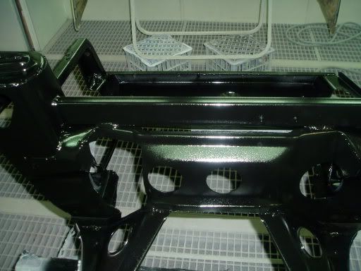

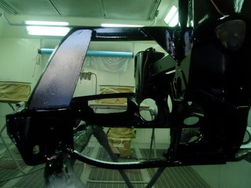

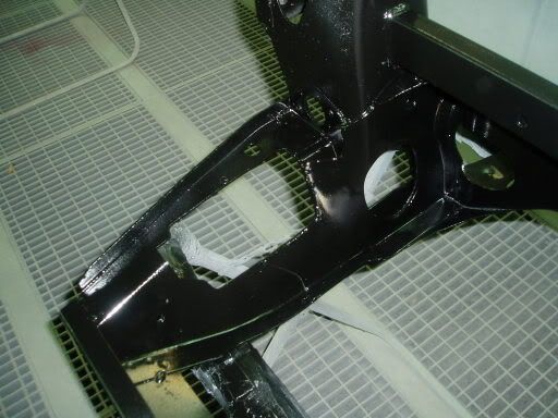

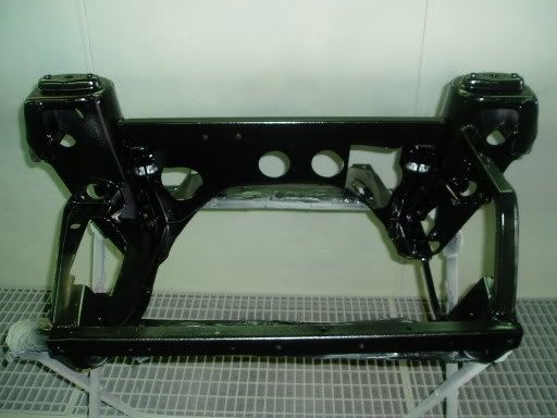

Sorry the pics are a bit dull :x ,But you can still see where all the changes are
Put the suspension on this morning hope to have the motor back in the frame 2morow :D

Looks Great! can you still use the original mounting points for the lower arms? doesnt look like you have to fabricate to much.

Yes the lower arms fit in the original place, the drive shafts are pretty small comming out of the gearbox so minimal cutting in that area. :D
