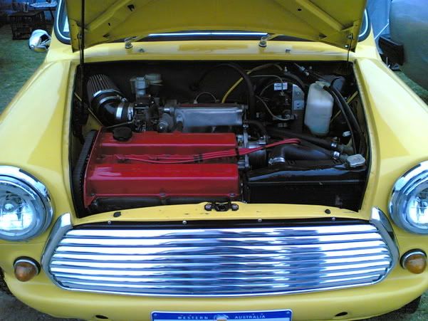

Heath's setup is very neat - the Toyota mota is a bit more of a squeeze
That said, he intends adding a turbo later!
PostPosted: Wed Jan 18, 2006 4:46 pm
and you can't tell with the bonnet closed :wink:

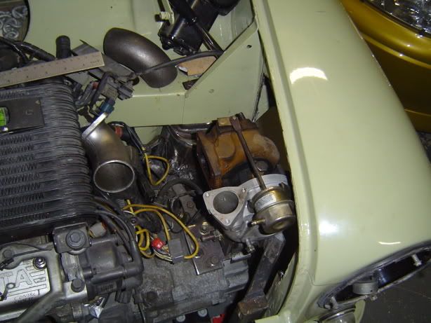

these 2 fit...minimetoy's and this NZ one:
Bling me up Scotty!

PostPosted: Wed Jan 18, 2006 5:36 pm
I'm aware of both of these projects, and until they are running on the road they don't count :P
The black one looks like it has had firewall mods done though, that engine sits a fair distance back if you compare it to the engine placement in running cars..
