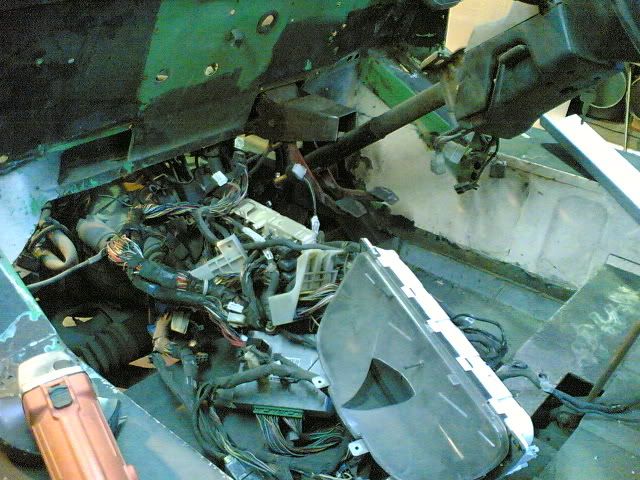

PostPosted: Wed Nov 02, 2005 10:01 am
I pulled the electrics so I could finish the panel work & re-route the wiring to suit.
Still lots of welding & other fiddly bits, but getting there :D
