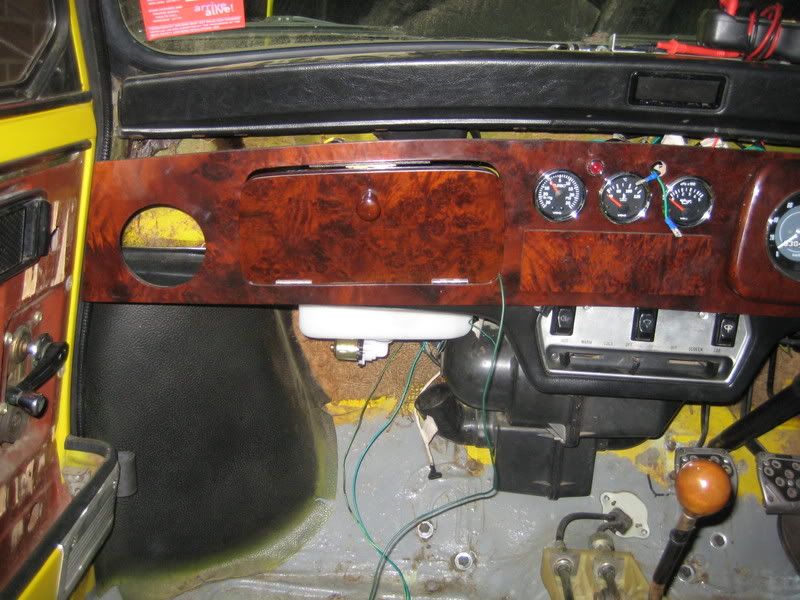

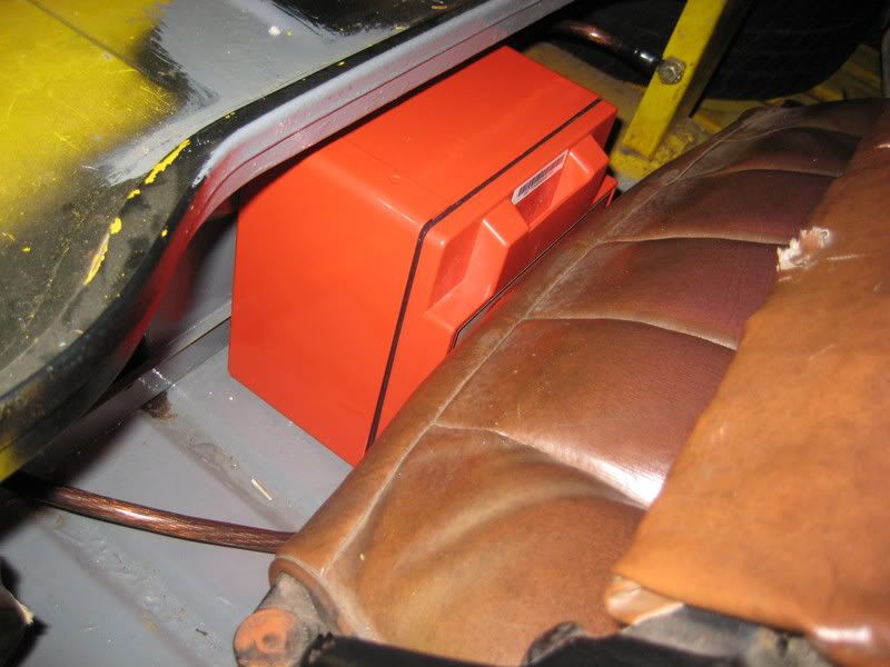

I have a couple more pics of little bits and pieces I have done this last week:

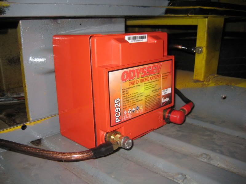

The new battery I mentioned before (can anyone say "ORANGE"):
I can now get the seat all the way back and keep the batt in the standard spot with this one.

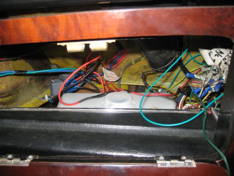

New home for the windscreen washer bottle: Please excuse the messy wiring - I have been troubleshooting a few gremlins.
It should almost disappear with a black carpet cover, and still give me a very useful glove box.

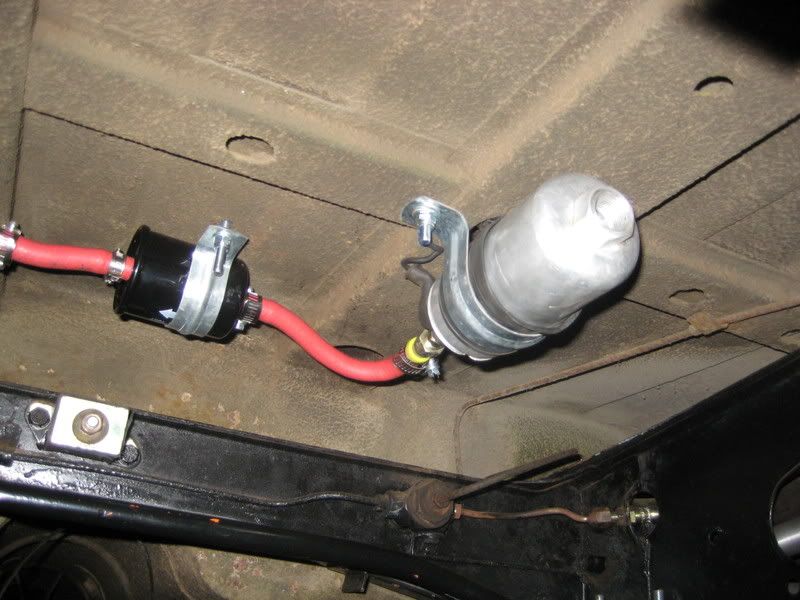

hey bud nice work wish i went the toyo route... just a question about your fuel filter? you said its an efi one? ive never seen a clear old school type efi filter like that anywhere in my 5 or so years as a mechanic.. sure its an efi one?
i use the same pump and the stocko z200 vn-vs commo filter.. just looks scary seeing it there :lol:
That filter in the pic is the pre - filter to stop crap from the bottom of the tank going through the pump. There is a proper metal cased efi filter after the pump that you can't see in the photo. :wink: (I think its from a tt300zx so flow shouldn't be an issue!)

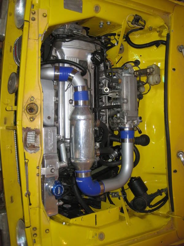

Below is a pic that shows the fuel line after the pump where you can see the black efi filter. I was just removing that pre-filter today (thats why there is no hose going to the pump) because I don't think I need it. I was just using it because the tank has not been used for some time and I didn't want to trash the pump straight up. :roll:
In that pic you are looking towards the front of the car, the other pic was looking towards the fuel tank at the back of the car. :)
Thanks for you comments though. :D All thoughts / opinions are appreciated.

PostPosted: Sat Jul 26, 2008 8:34 pm
Smart thinking.
Once you've been running an EFI system for a while the tank gets flushed anyway, as at least 2/3 of the fuel on average gets filtered & returned to the tank.
Very nice work, top marks 8)
PostPosted: Sat Jul 26, 2008 10:51 pm
Posts: 338
I would still use a pre pump filter/strainer I had a pump fill with crap and die.
I use a volvo inline one on mine it has 1/2" hose lines in and out so no restriction.
Just my 2 cents
Just my 2 cents
After talking to a few other people, I agree its probably best to keep the additional filter there. I just have to find one that will fit without moving the pump too much. (not that its hard to move the pump anyway) :roll:

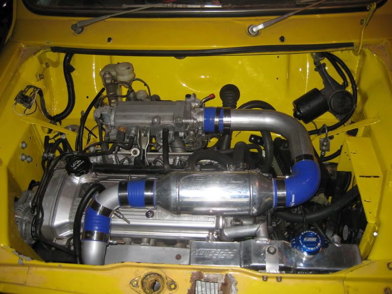

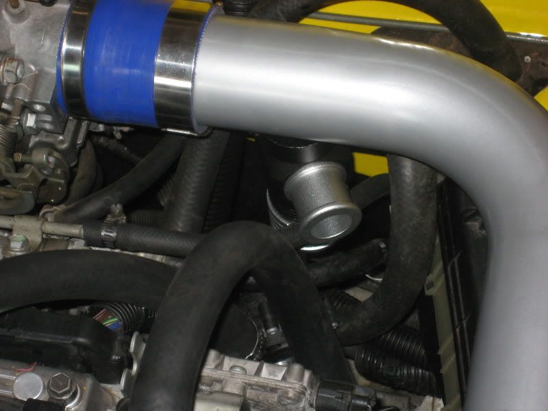

A bit of an update from the weekend:
BOV mounted and intake pipe painted::

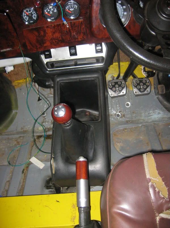

And a bit of interior bling that I couldn't resist - even though its what I should be spending my $$ on at the moment. :? (gear knob and handbrake handle)
haha I should really be buying new seats and fixing the centre console. :roll:

i have one of those BOV's on my GT, works a treat plumb backed, very quiet.
are you going to run it as plumb back?
1992 Toyota Starlet GT EP82
PostPosted: Mon Jul 28, 2008 2:10 pm
Posts: 614
Location: Wyndham Green, Vic!
I have to run it plumbed back for rego reasons. It is still going to be loud though, as my intake pipe is very short, so it will vent very close to the air filter. hehe. :lol:
I haven't plumbed it back yet because I need to get a hose reducer as I don't want to run a large diameter hose across the engine bay.(the bov outlet is pretty big!) :?
-James.
Toyota 4EFTE Powered Minivan.
PostPosted: Mon Jul 28, 2008 2:23 pm
Posts: 501
Location: Nthside Brisbane
I have the same situation with mine, but this BOV is deffinately one of the quietest ones out there, i have mine plumbed back but was curious as to how it sounded vented to atmo, still fairly quiet as opposed to the turbosmart type 2 i had lol, that got annoying real quick.
