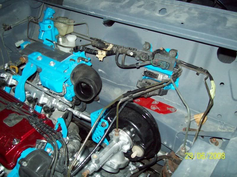

Spent a few hours on Sunday in the workshop, trying to get a bit done and little by little it's nearing completion. The brake lines and clutch MC went in were installed and bolted up firmly. The brake line guy is coming to fit-off the ends mid-week so that will be all the hydraulics taken care of.
Lines and Clutch MC installed:

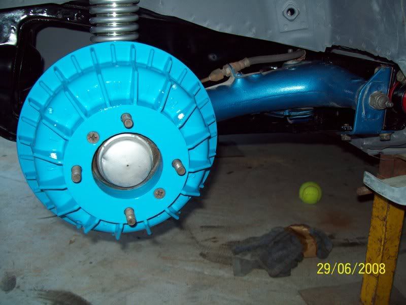

Installed the rear swingarms. I have installed them without the tracking and camber brackets as I didnt want to mark or scratch them seeing as this is just temporary. Installed the Suprfins as well:

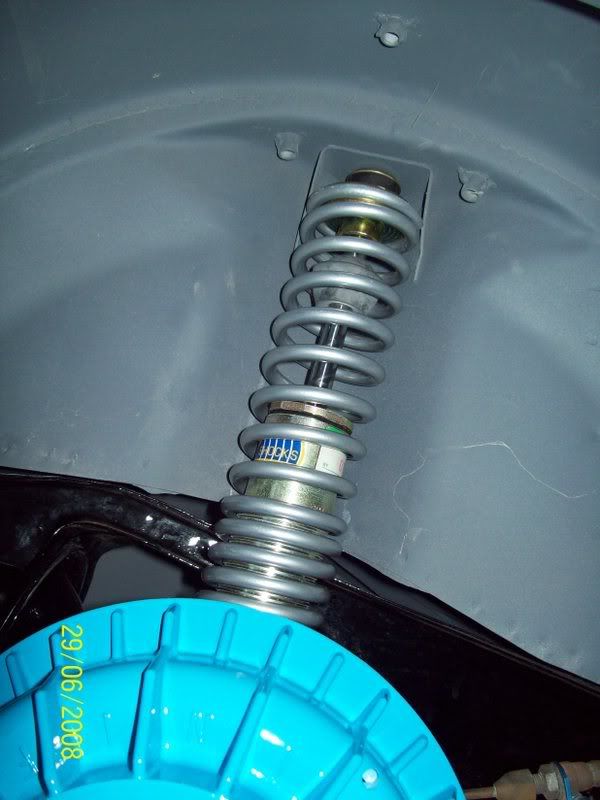

And with that came the rear coilovers:

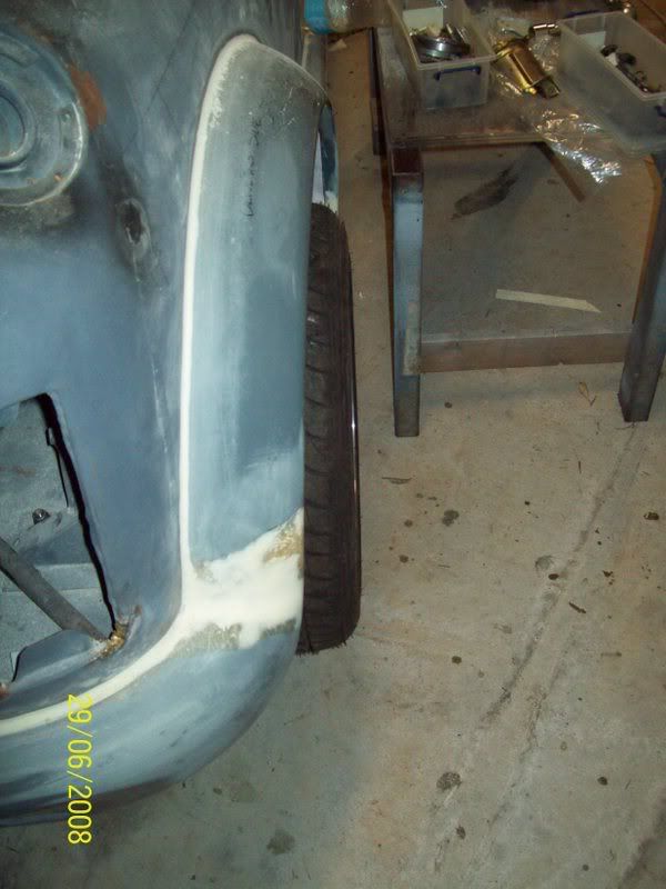

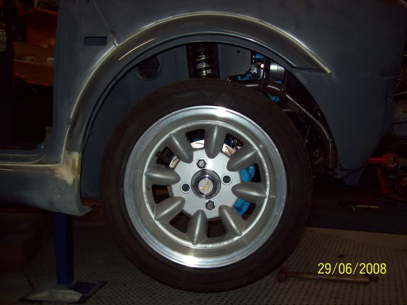

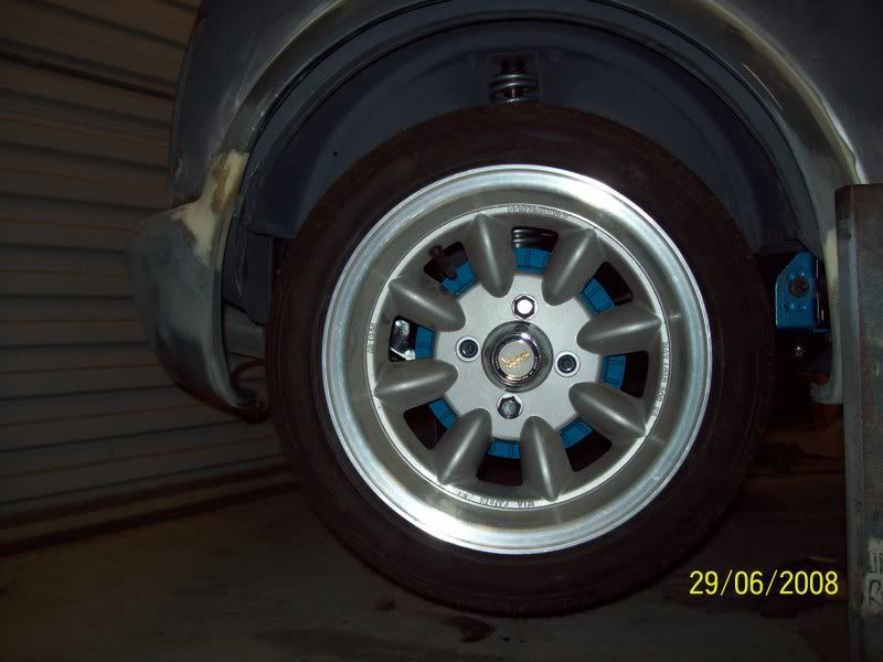

I decided totest fit the wheels while I was there. The fronts look great, but the overhang was a bit more than what I thought. No matter, should pass OK.

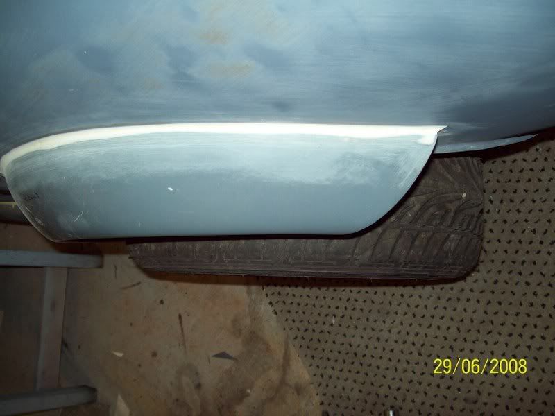

The rears were a little bit better in terms of overhang. Cant wait to get the whole thing painted and finally finished because I think it will look uber slick!!

Tricky were the brake calipers painted in any sort of paint inparticular? I want to paint mine but have been worried about the heat disipation? Was tossing up wether to maby powder coat?

Tricky, I think you'll have no trouble with the rears, but I'd suggest you wind on a bit of negative camber on the front and tuck the wheel tops in a touch. Might be a tiny bit too much rubber hanging out there...

Its 2-Pak PPG but with a special hardener put in. The hardener gives it some heat resistant capabilities. The hardener is only available in the Delfleet and Deltron range of paints. You have to use the hardener in the undercoat/primer as well as the topcoat. It apparently gives the paint a heat resistance in the order of 400 degrees or so. BadassMini should be able to give s some more details as he uses the stuff every day.
Simon,
Yep, good idea Ol' Sock. Might wind about 1.5 degrees negative on just to be on the safe side. If in doubt, register with JC's 12 x 6's :D
