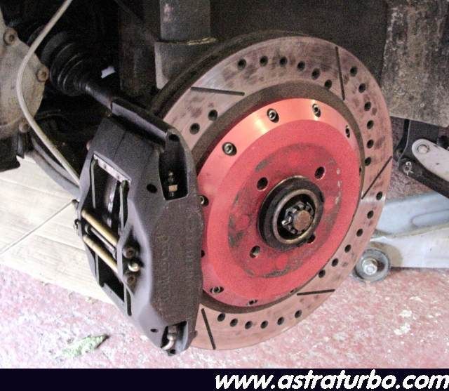

Wilwood upgrade on a European Astra.....
Which is opposite to Tony's?
PostPosted: Mon Sep 10, 2007 1:08 pm
Err no!!!
Its front wheel drive.
That is a pic of the passenger side, the engine is in front of the caliper (i.e. its a leading caliper, like the Mini). Have a look, you can see the driveshaft and the gearbox casing.
Therefore direction of rotation as you are looking at it is counter-clockwise!
So therefore, exactly like Tony's, and that pic of the Lambo!
PostPosted: Mon Sep 10, 2007 2:46 pm
Posts: 3981
So it is! I should know by now not to argue, but its bred into me.
PostPosted: Mon Sep 10, 2007 2:49 pm
But if you dont challenge things, how will you ever learn?
:wink:

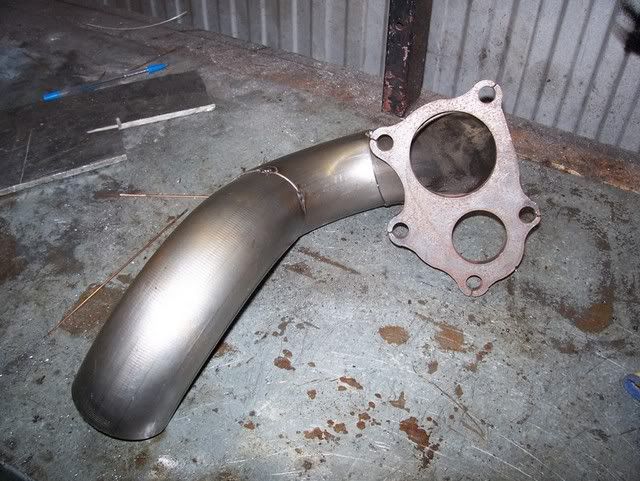

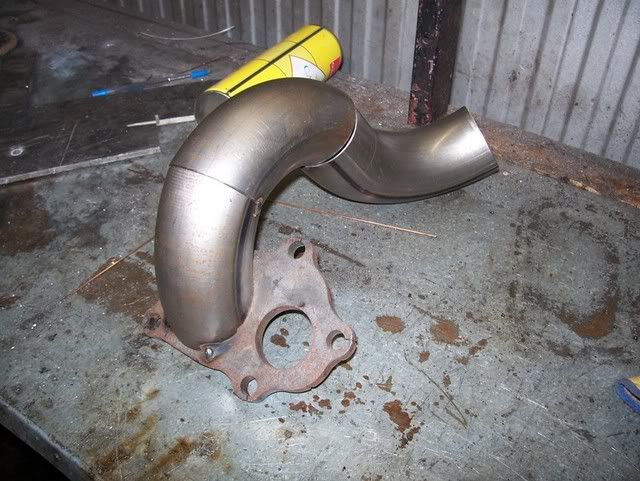

Barbie came home on Saturday for a brief spell, so we could do some more work on her.
Still to be done is the alternator, gear shift linkages, gear shifter mount, and guard cutting for the 13 x 7's. As well is the electrical etc, but this will be outsourced to an auto electrician. So, still a fair bit of work, but not daunting.
I dropped into the fabricators today, to see whether they had finished the dump pipe for Barbie. Its mostly done, with just one more 45 degree bend to go on, the mounting flange and the wastegate pipe - should be fully completed by Thursday or Friday.
Some pics.........
Tricky

Thats gonna be a real nice dump pipe there. Similar to what I have in mind.
Are you going to try to extend a divider into the turbo side of the flange for better flow?
Some examples below.
Neat and not too hard to do.
Right most option best of these obviously.

Just a quick one, what are you making your dump pipe from, just exhaust tube?
PostPosted: Tue Sep 11, 2007 12:27 pm
Hi Morrie,
Thanks. The wastegate pipe will join up with the dump pipe proper just before the next 45 degree bend is welded on, so at the very end of the large pipe as you see it. They say try and make the wastegate pipe about 18 inches long before joining into the main exhaust stream.
Miniboy - the exhaust is made out of mild steel tubing, mandrel bent. Its the standard pipe that exhaust shops would use.
