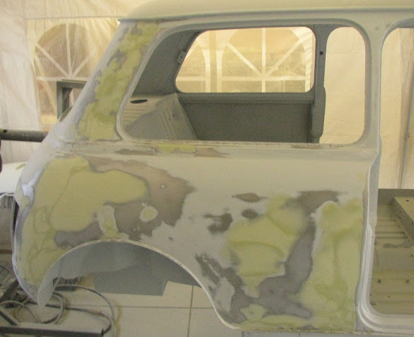

PostPosted: Tue Dec 19, 2023 7:56 pm
Fill, sand, fill sand, fill, sand...
Both sides of the shell were worked on with repeated applications of filler and sanding to get everything mostly flat/smooth, and all areas with filler or bare metal were resealed with 2 coats of epoxy primer.
I also 3D printed a simple piece specifically for the rear quarter window opening when I was filling/sanding a rust repair.
The rear bumper has been deseamed so this required a thin skim of filler over a majority of the beaver panel to get a even curvature over the panel.

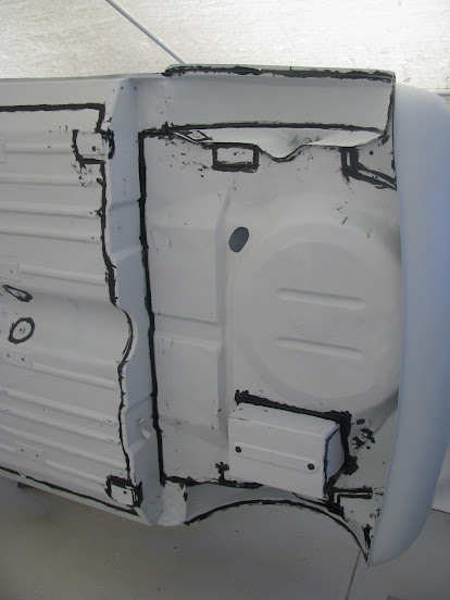

All areas all over the shell that needed seam sealer and underbody coating was then scuffed with a maroon Scotch-brite pad to prep it.
The panel joins in the engine bay and front bumper area had seam sealer applied and any excess carefully wiped off, leaving only the seam sealer at the panel joins.
For the roof I taped off the gutter and liberally applied seam sealer in the gutters, making sure that the two drain holes in each corner were still open.
Seam sealer was also done in the interior
The bootlid and doors then had seam sealer applied over the door skin edges (I could only get white colour for a new seam sealer cartridge)
