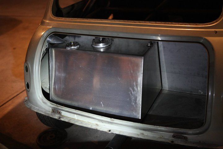

That's huge!how many litres is it? I was thinking of something like this which would take up the whole boot floor almost but could be covered and retain some space. I was just a bit worried about rear impact but I guess a std tank is right against the back panel anyway!Image

Not sure how big it is yet, might measure it up tomorrow if I remember

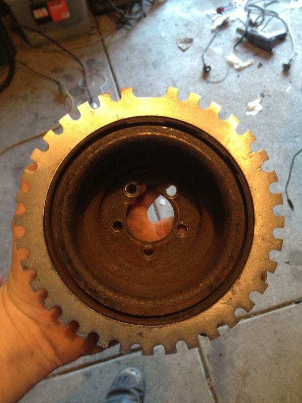

Not a massive update but my trigger wheel arrived so after trying to figure a way to mount it decided to make a home made lathe and machine the outer pulley until it was a press fit with the trigger wheel,
Result being this. Now all il do is position it, double check its correct with the trigger sensor, and weld it on with a couple of stitches.
I've got my shielded cable now too so I can press on with the ignition system!

Mine is -
555 long
335 high
350 wide at bottom
210 wide at top

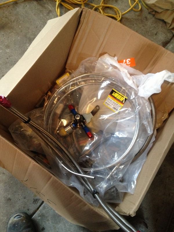

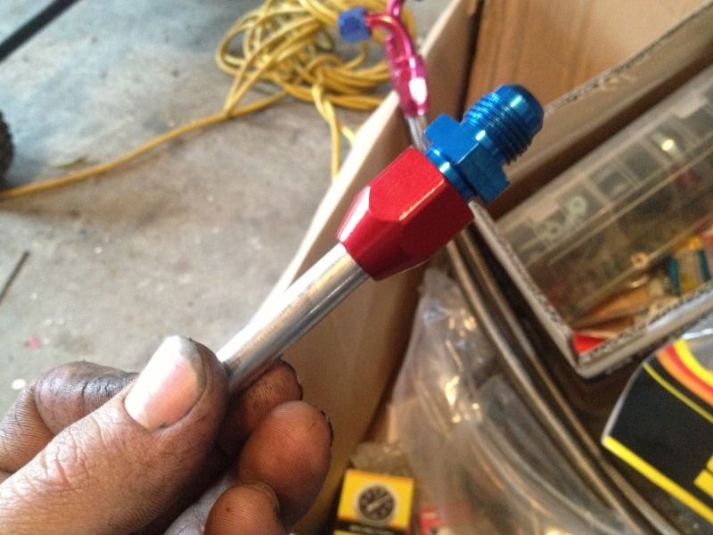

Got my order of fuel related gear from jegs, new regulator fittings and these cool hard line fittings so I don't have to use hose clamps!

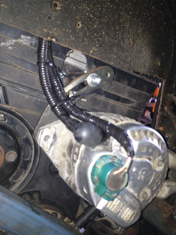

Also, does anyone know what each of the alternator terminals are? Trying to wire it into a mini loom

Alternator wired up

Glad you got it sorted.
Looks neat.

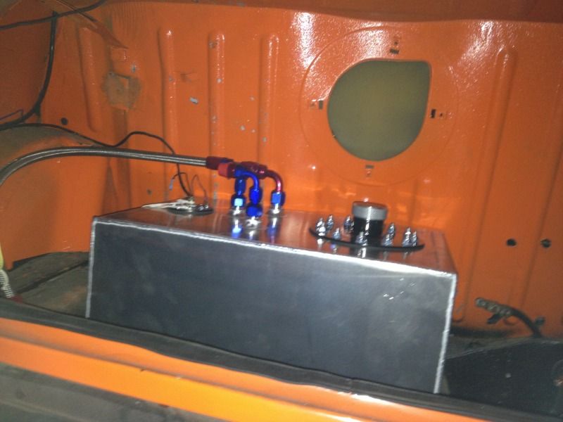

Got my fuel cell and started setting it up in the boot, it's 50 odd litres so that will be plenty!

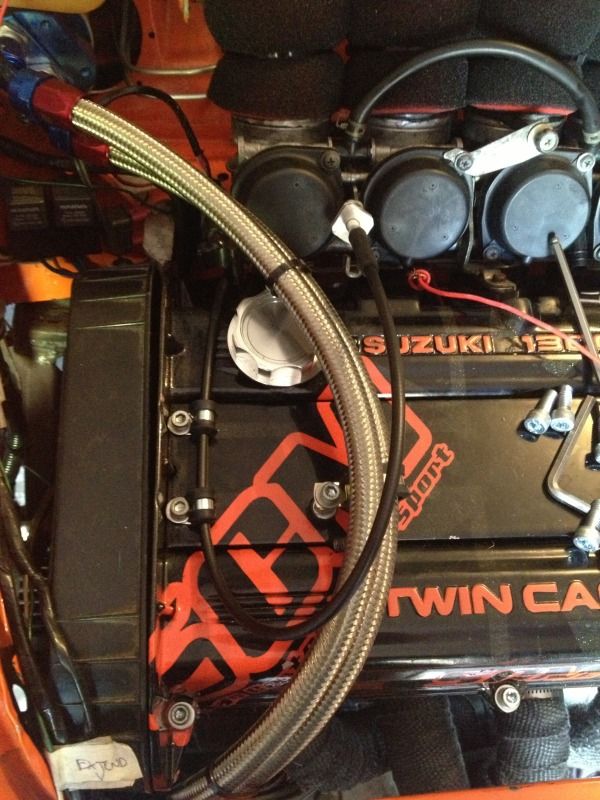

And turns out the rover mpi throttle cable is perfect for the bike carbs! Pedal travel is about 2 inches so may need to adjust the pedal pick up point but meh..
