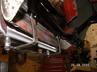

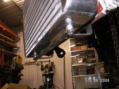

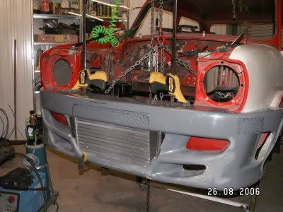

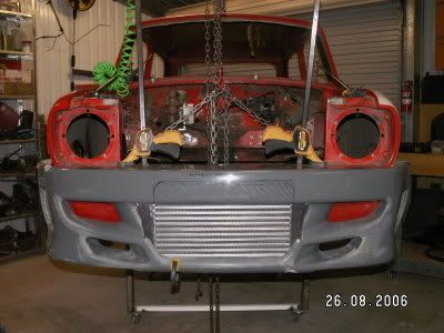

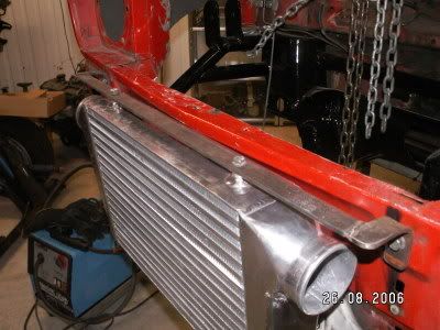

FMIC progress as promised. Still a long way to go though, and lots of reconfiguring of the front spoiler. But its a start. To be mounted still are the 100mm VY Commodore fog lights, indicators and cold air intake.
Top bracket:
Bottom bracket:
Bottom bracket mounting to IC:
With front spoiler:
And again head on:
Like I said, still lots more work to do to modify the front spoiler and get it ready for painting. BTW - Zeemax quality is absolutely crap!!!

hows the room with the bodykit around the fmic? i'm looking at going along the same route with that kit....
PostPosted: Thu Aug 31, 2006 8:13 am
Matt,
Sorry to hijack your thread!
Idearat,
Clearance was barely minimal for the FMIC with the bodykit on.
I had to cutaway a fair amount to get it to sit right back.
Its a 3-inch IC, so fairly deep but it is as far back as it can go, tilted back at the bottom about 8 degrees.
Some alteration of the bodykit will be happening to accomodate the driving/fog lights and cold air intake for the air-box. The pipes will be routed through the old indicator/parking light apertures. There isnt much room there. All piping will be 2 1/2 inch, or 64mm and most of it will be alloy (some bends to be fabricated to allow for the tortureous route).
I hope this helps. I will host some more pics (own thread this time - sorry Matt) after I have done the fibreglassing.
