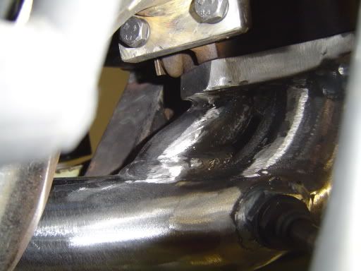

I was thinking of having 45 or 90 degree bends into the log which would have allowed me to lower the log, but found the clutch slave cylinder was in the way so ended up with the straight out pipes.
I have to say i am happy with the result and feel that it will work well as i have choosen large diameter pipes for both the log and runners. The runners actually passed all the way through the flange and have been welded from the back and then ground flush. This has allowed me to have the max size runner i can fit and reducing joints where turbulance could occur.
I am unsure as to actually trying to run pipes/elbows into the log as i think it would be restrictive to the upstream cylinders. If you find you want to this then you should try and make an equal lenght manifold (probs for round nose due to restricted room).

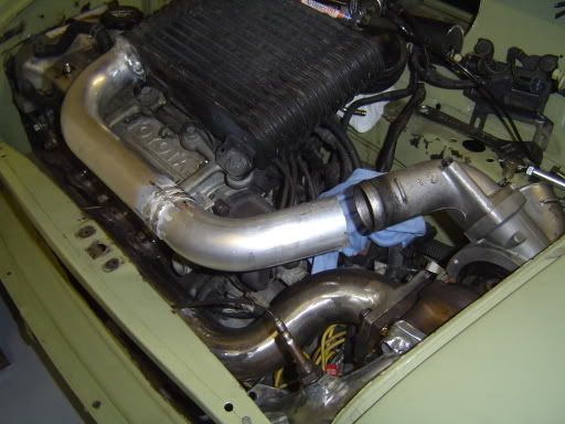

Some update photos of the exhaust manifold, dump pipe and modified intercooler intake pipe.
This photos shows the additional pipe installed to help with the wastegate gasses.
Dan

Dan, mate that is a work of art. Very well done, a very neat effort. Are you welding with gas mig (GMAW)? Also I gather you have welded one pipe directly onto the intercooler, does this mean you can also weld aluminium? Either way mate great effort. Nearly there mate I better get a wriggle on :lol: . Watch out for the MAP sensor :D

pfwhroar! THATS BLOODY AWESOME! i am loving this approach more and more with every update! just wondering why you decided to stick with the stock IC instead of going a liquid-air barrel IC? other than the fact that it would be just another THING to find room for :P

Matt, I am welding with gas (argosheild) and finding i am getting much better welds by far. The Aluminium welds were done by one of my contractors he does a good job.
Its good to see your issues are coming to an end and i hope to drop in and see you in the next couple of weeks.
Inazuma, decided to stick with stock IC at the moment because of dollars, but it will probably happen at a later stage. I'd make another set but with two kids and trying to finish my own project i don't think i have the time (i suppose it depends on how long your project takes).
