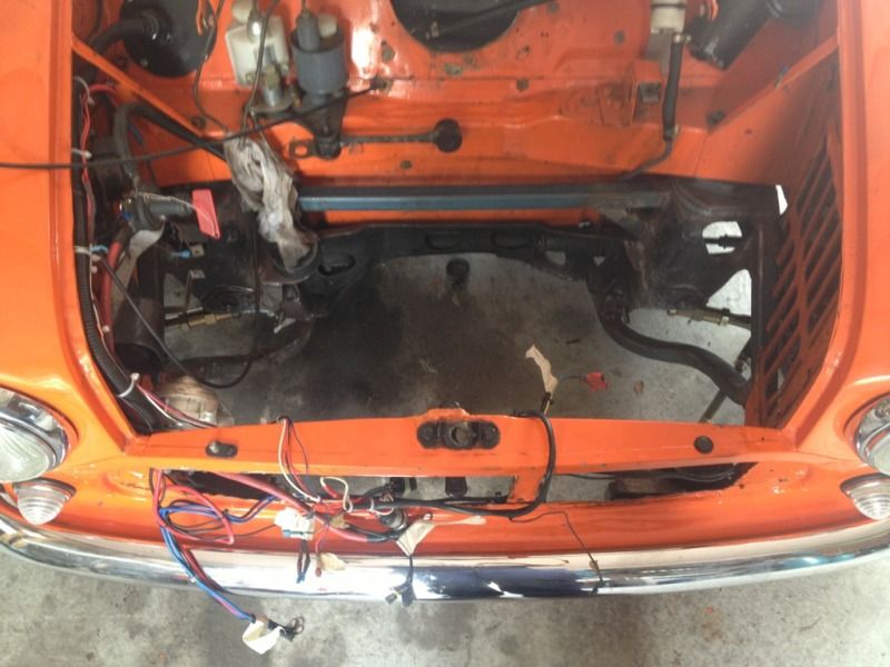

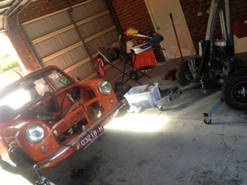

Well I had a spare 2 hours today so I thought bugger it...
Pulling motors out is so much easier with an engine crane to lift the car up!
No turning back now! It's happening!

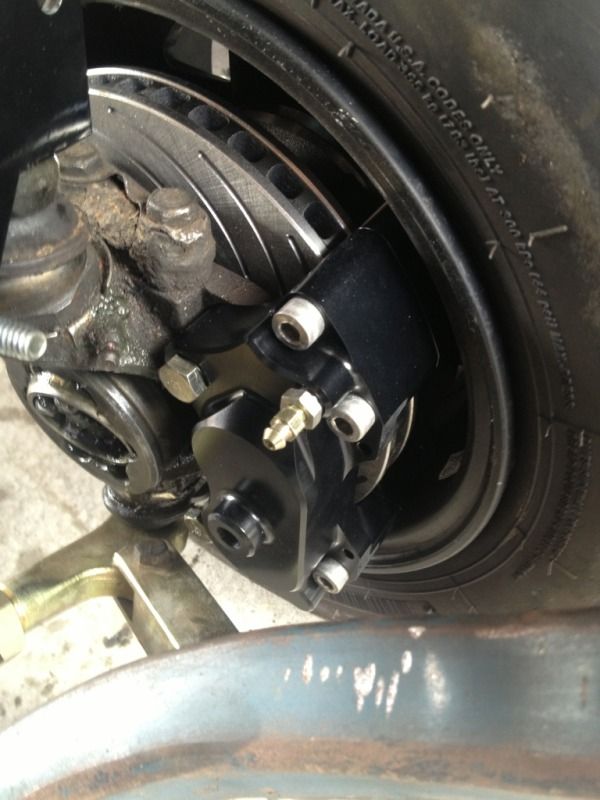

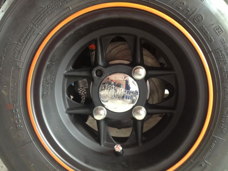

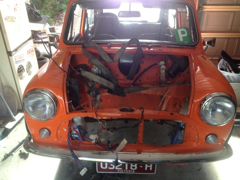

Did a little bit more work today.
Fitted all of the suspension and brakes to the front subframe minus the shocks. These are the minisport 7.9's under jbw mambas and they fit, no stick on weigts though which is ok as mine were on the inside so a couple of clip on weights will work fine!
Then went about getting the frame into the car. Fit perfectly! Every bolt hole lines up perfectly! Very happy about that still more inner gaurd trimming to do for the radiator and alternator but so far so good!
Sigh of relief that's for sure

Good to see you're sticking with 10'"s
PostPosted: Mon Dec 17, 2012 5:25 pm
Posts: 750
agreed. it'll look boss on the black 10" mambas... especially knowing whats behind them and under the hood.
