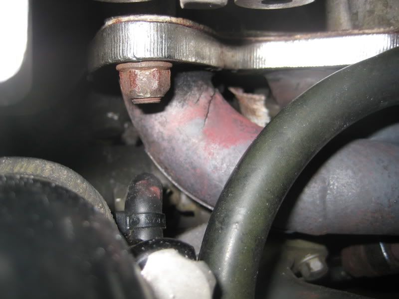

I'll let the photos do the talking: :cry:
I had thought the gasket had blown through, but I pulled off the exhaust wrap to find this.
Its what you get with a cheap chinese stainless manifold. :(
So I'm in 2 minds now:
1. Borrow a TIG and try to fix what I have (I have never TIG'd before only MIG) :?
2. Buy a new thick walled mild steel manifold and dump pipe to suit a TD04/TF035 (Subi forrester XT) - I have a TF035 sitting in a box in the garage which looks to be in pretty good condition. :wink:
Hmmmm.......

PostPosted: Mon Jul 04, 2011 9:43 am
Posts: 1461
If it's cracked twice like that already, I'd be ditching it for sure... Either new manifold to suit the old turbo (probably heaps cheaper, won't need to change anything else) or get a new manifold to suit the new turbo which will probably need a further mod to match up the back of the turbo with the old exhaust.

You're on the same page as me, but:
Gordo wrote:
If it's cracked twice like that already, I'd be ditching it for sure... Either new manifold to suit the old turbo (only slightly cheaper, won't need to change anything else) or get a new manifold to suit the new turbo which will probably need a further mod to match up the back of the turbo with the old exhaust. + opens up the modification ceiling a lot so opens the flood gates for futher mods like full ECU upgrade + injectors + +....
I always love an upgrade but hate the extra costs involved!
:lol: :lol:
Also, I haven't taken the manifold off the car yet to see the full extent of the cracking. :shock:

PostPosted: Mon Jul 04, 2011 9:02 pm
Posts: 953
Location: NOR, Perth, W.A.
While you have the manifold etc off, fabricate a brace between the turbo and block, or dump pipe and block. I've seen manifolds crack before under the (unsupported) weight of a turbo and exhaust.

PostPosted: Mon Jul 04, 2011 9:10 pm
Definately go for option number two.
Those cheap stainless jobs are very thin-walled, and continual heating and cooling (heat cycling) just fatigues them and they ultimately crack - as you ave found out.
They are usually too thin-walled to repair successfully.
Buld yourself and new manifold from thicker walled stainless or mild steel for the new turbs and go from there. They arent that hard!!
