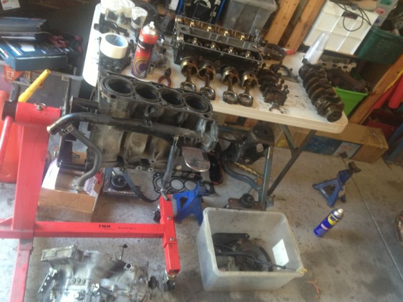

Well now that I have the go ahead to build the car the fabrication shop has turned into the engine shop.. Mock up front is now out the way and motor came out, within an hour it looked like this
Nothing too ugly in there, lots of carbon on the pistons.. But the crank was like brand new... Contemplating wether it needs to be sent away to be honest!

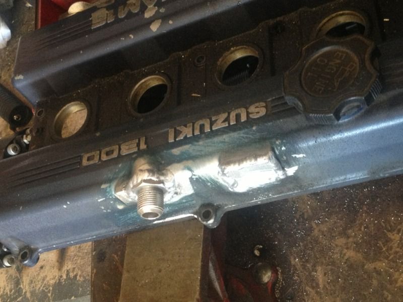

While I was there I also blanked off one of the breathers for pollution control that isnt required and added a fitting on the other so I can run a speedflow hose and fitting to the catch tank
Now I can paint the cam cover!
