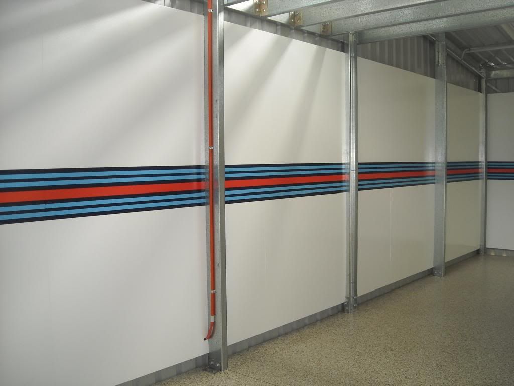

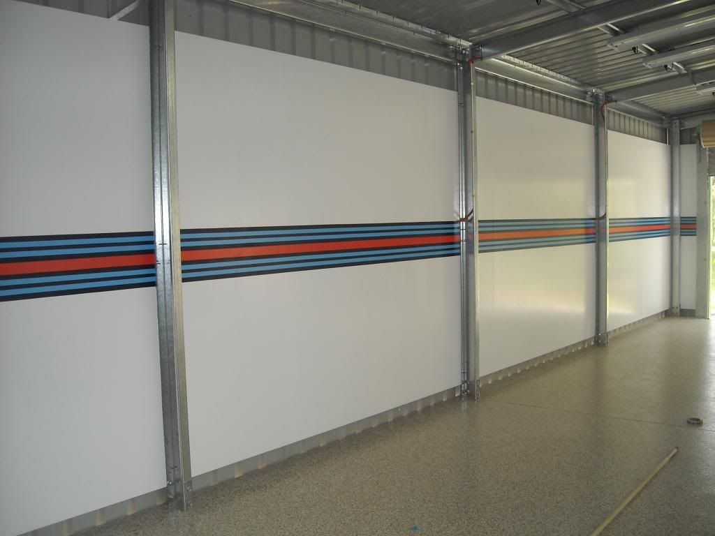

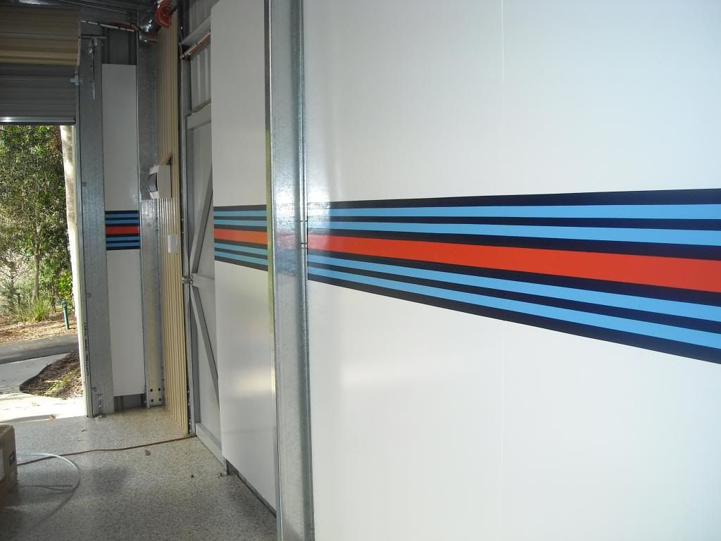

Thanks for the kind words everybody, and now for the revealing......
Its not 100% perfect, there are a few runs, some bleedthrough under the tape in places, and a few blemishes here and there, but all-in-all, not bad at all. What do you all think of the new Martini Garage??
Does this mean all I can work on is Porsche's and Lancia's???
Now to finish off the electrical on those walls, and get ready to put the dividing walls in!!

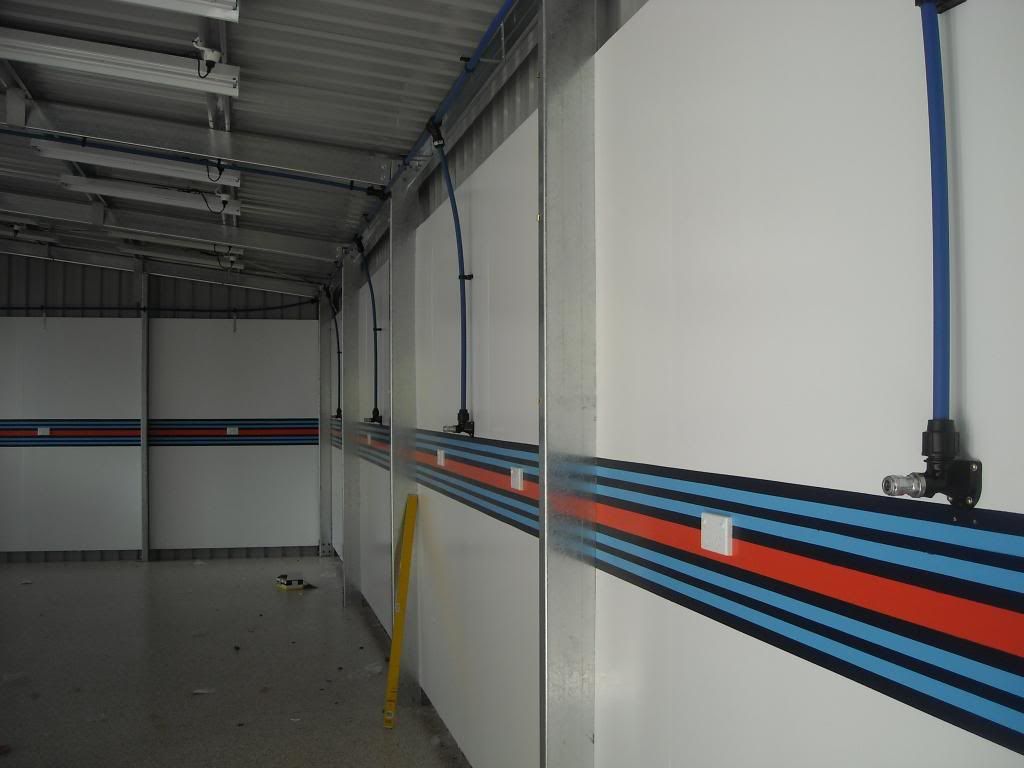

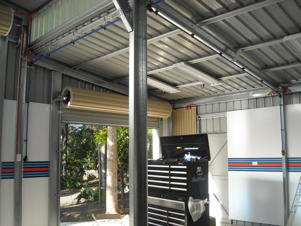

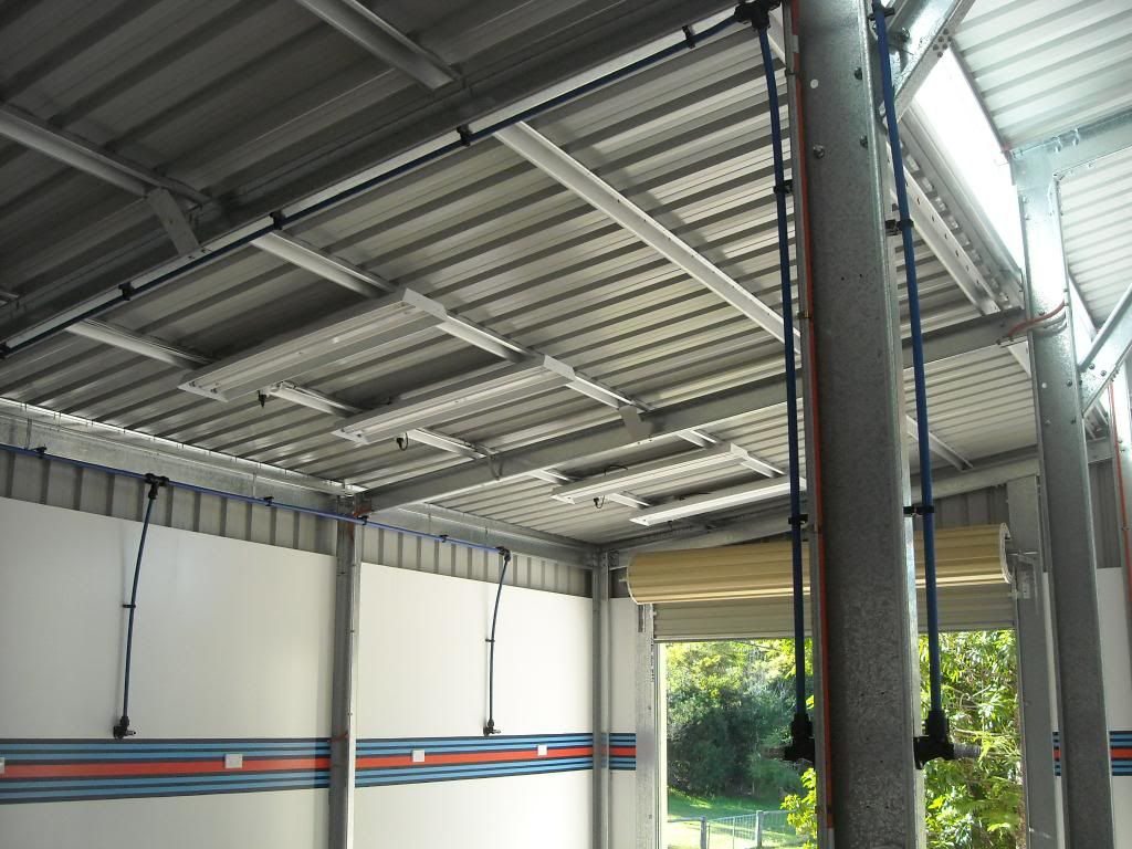

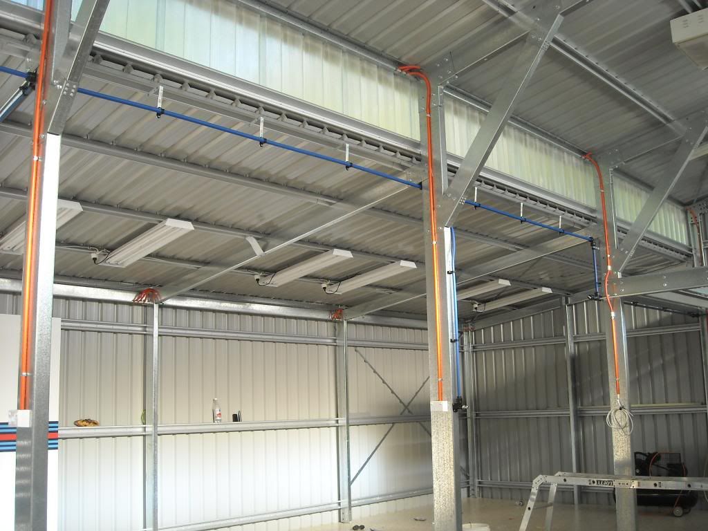

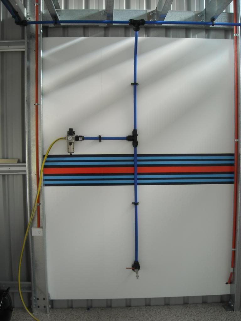

This week I decided, now that the stripes are completed, to finish off the elctrical circuits along the walls, and also to install the compressed air reticulation that services the workshop. In all, there are ten nitto outlets in the workshop, three that feed the asembly area, two service the machinery area (to blow swarth off and help keep the machines clean etc), two service the hoist (so two people can work on a vehicle at the same time, from opposite sides), one services the sheet metal fabrication area, one services the bead-blasting cabinet, and one services the retractable hose-reel at the front of the shed.
The electrical is almost finished, except for the runs along the dividing walls which arent in yet. The air, is virtually done, except for the line that feeds the spray booth, for obvious reason.
Without further adue, here are the pics:
Connection point from the compressor to the filter/regulator which feeds the workshop, and the drain point which will have a hose to the outside:
The brackets took the longest time. Here you can just see the spur for the spray booth on the top right hand corner:
Well that's it for now, another big day tomorrow (which is actually today, as the air lines were finshed yesterday). Will post more tomorrow.
