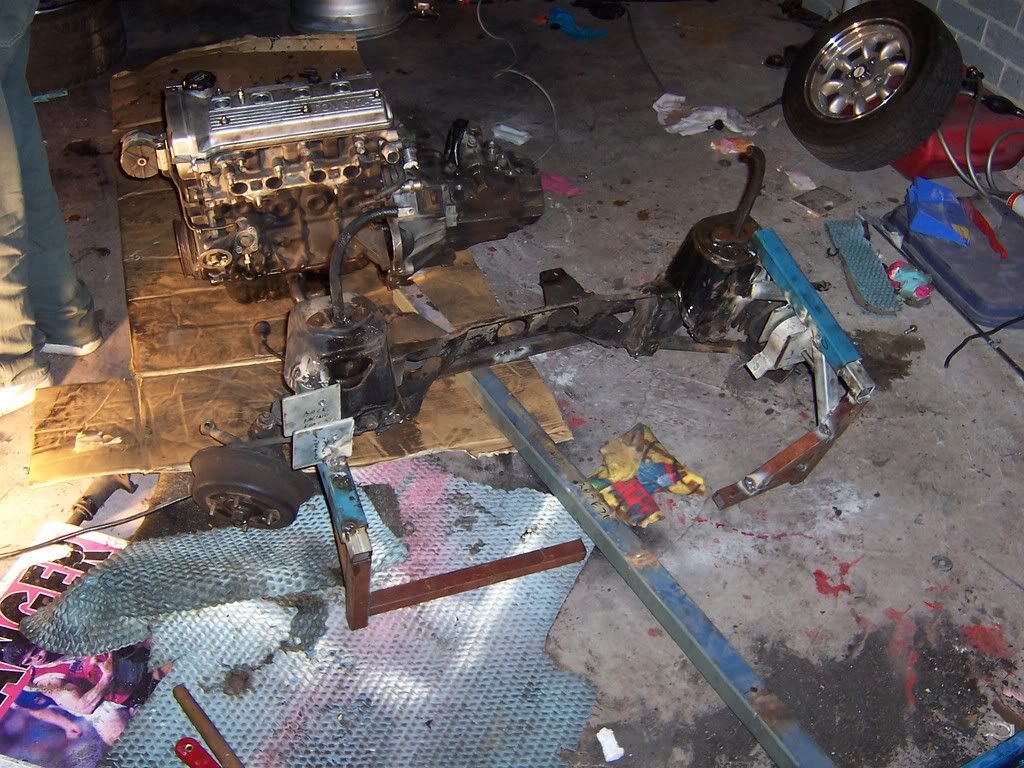

a few more I missed
one other thing, the engine mount on the back of the gearbox, seems extremly low to the ground, maybe if I turn it upside down?
who knows, Im not very good with this stuff time will tell, im just glad I have mates to help me that no what they are doing!
im getting pretty pumped now!! I JUST WANT IT DONE!!!!!!!!!!!!!!! its going to be awesom

i cut my rear mount up welded it to a plate that fixes to the back of the gearbox and then made a fixing point on the subframe. The engine needs to be fitted first and then the mount installed and fixed in place.
Dan

Answeing your pm, your biggest drama with running the exhaust behind the motor will be the limited access once you install the intake manifold, starter, shafts etc. You will also need to decide where to put the water lines for the radiator if you mount it in the rear.
You will find most of your engine bay will end up being filled up with sruff.
Dan

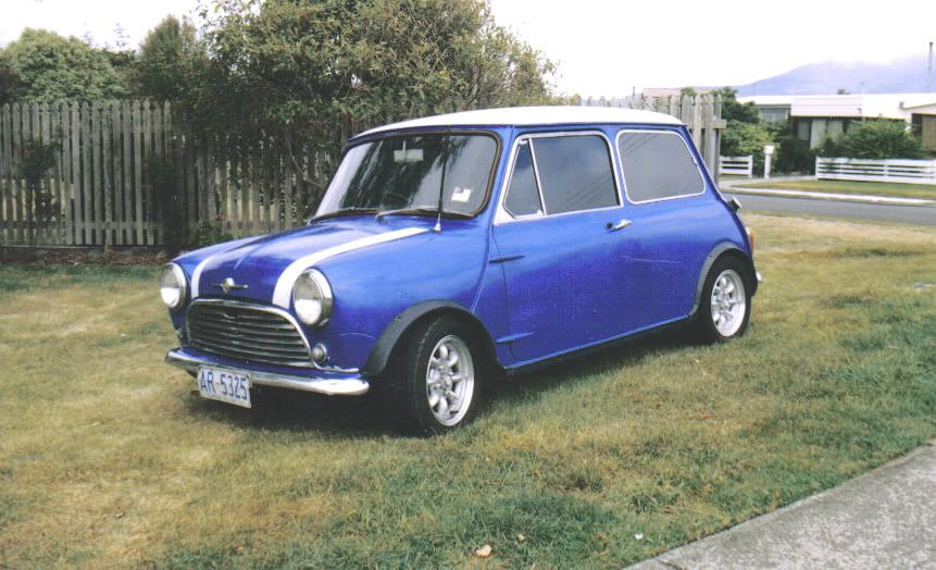

well here are some pics of what my mini use to look like before we started this!
I cant wait until it gets back from the body works for all the panel stuff, then I can start painting it!!
