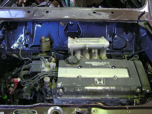

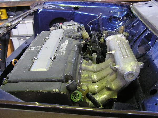

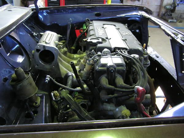

I must say, that is a tight fit Paul.
And nice work on the inlet manifold 8)

nice work mayte!!! 8) did you have to cut and shut that inny mani for it to fit? looks like you've done somthing there.. looks good but, hope to see it finished soon :)

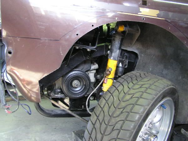

The cradle was made to fit a vtec engine into a round nosed mini without extending the front. The inlet manifold had to be cut to fit. I have an aoutofashion body kit. It has hi - low suspension with springs and spax shocks. It has metro turbo 4 pot vented disc brakes. I will use a links computer to run the engine.
