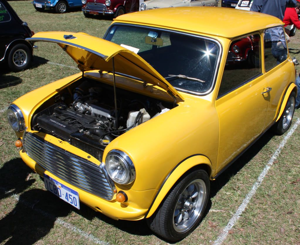

this is my car. love it.. its fast reliable has a 5th gear.. you can have a conversation in my car when on the highway.
I would love a turbo but it's to much farting around rad in the boot etc.
and mine is already high compression, & i can not be buggered to pull it out to change pistons.
this is doing 105ATW & it's enough for me, Bd10 cams very drivable.
i never did the conversion but Gti tec josh does drive in drive outs, in sydney.
good luck.
