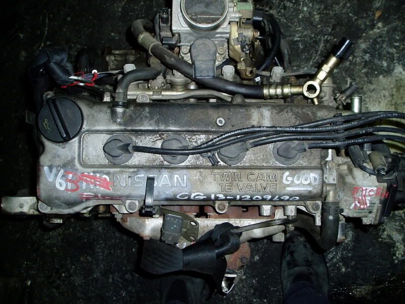

what do you guys think its either this or a F6a/K6a
also this one will cost me far less from a mates wrecking yard
its a cg13de
57 Morris minor
88 Rover Mini
PostPosted: Fri Jun 15, 2007 8:46 am
Posts: 11847
the nissan march engine?
58 kW... not bad...:)
a fairly recent make too..

yeh they seem to be a tuff little motor. I have not had a chance to measure one up but the pics i've seen over the net they look pretty compact. Put a nice turbo combo on it and i can see it matching a 4efte. Looks like a mini sr20 with that head too haha.

If there is room i will turbo it, your right brad it does look like a baby sr it even has chain driven camshafts under that cover

hey brett, they seem like a decent swap but i havent seen a gearbox yet as this ones an auto
upside: :D its all alloy, quite a compact head width and the water pump is close to the block
Down side: :cry: the oil filter is at the back of the block (firewall side)
does anyone know if they are rod or cable shift + hyrdo or cable clutch

What does it matter that the oil filter is on the other side? Doesn't tjat mean that it can be hidden along with the starter motor, surely the oil filter wont poke out that much....

it would be a pain in the bum to change

we tried a n12 pulsar gearbox today and would you belive it fits :o and its very small but was run behind motors up to 1.6 so it should be strong , he also had 4 in stock so they seem very common and cheap 8)
also a n16 flywheel fitted too 8) isnt it cool when everything is interchangable
the whole engine and box measured up at 74cm long which will fit nice
